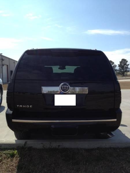

Looking to replace mine and was wondering if anybody had any tutorials on how to do this? Is it hard to do? Thanks, DW!:Handshake:

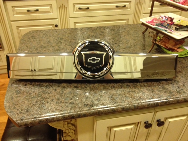

Thanks will the nuts and clips come out of the old applique and mount in the new one? The one I'm looking to buy doesn't have them.
Is it necessary to remove the wiper motor to access the bolts? Thanks for all the help everybody!
