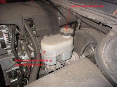

Open the hood, since your facing the hood, on your right all the way back, you'll see the master cylinder
[/IMG]
Now there are 2 things you got to do. First remove the cap, so it can breathe,
[/IMG]
and 2 make sure that the brake fluid is at least half way down (in the middle between Min and max) Why you ask, well when you put the new pads, the brake fluid is going to go up, and the last thing you want is this puppy overflowing.
Remember this, they don't recommend to remove the cap, due to the fact that brake fluid is prone to moisture in the air just by leaving it uncapped. Now this is the way I have always done it, but if you feel better waiting till you push the pistons in, then wait till then, and have somebody remove the cap when you are ready to push in the pistons, and put the cap back on, when your done pushing in the pistons, repeat on the other side.

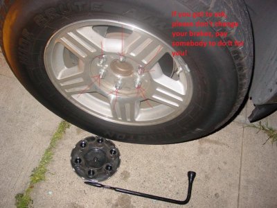

Step 2:

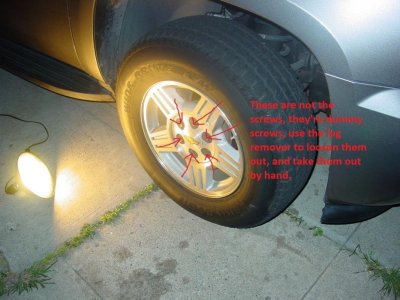

Lets get the tire off, look at the 1rst picture for notes
[/IMG]
Now if you don't know how to change a tire, you got some major issues J/k, just loosen the nuts please, (Do Not take them off)
[/IMG]

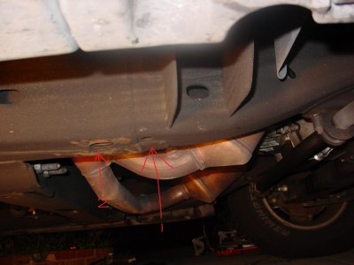

Step 3:
Lift points, (1) is where the your tahoes jack goes, (2) is where you would put a jack stand, but i did it the reverse way, you'll see in the picture. Make sure your jackstand is rated for 2 tons, which is 4000 pounds

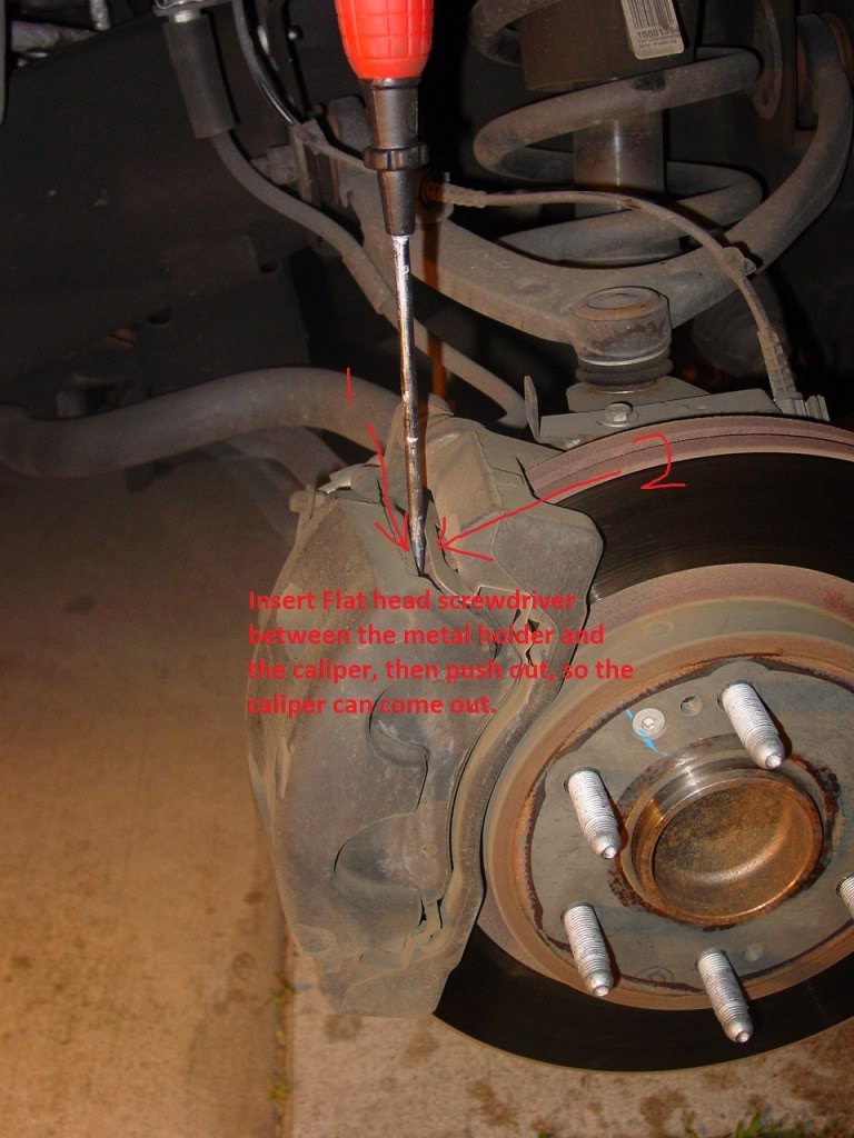

Go ahead and remove the tire, once the tire is removed you should be looking at your rotor. There are 2 screws that you got to remove, on my tahoe the screws were 3/4 inch, so of course i used a 3/4 inch socket to remove.
[/IMG]
[/IMG]
Step 5:
I used a flat head screw driver to remove the caliper, make sure that when you pop it out, your left hand catches the caliper, (Do not let it hang) and rest it on top of the rotor. When removing the caliper with the screwdriver, take care as to not gouge the rotor.. Also, take a good look at the rotor, give it a spin or pull it off when the caliper is off to inspect for any gouging or warping. If found, get it resurfaced at any local autozone, or such store. Most of those stores will resurface for free. If its out of tolerance to resurface (not sure what the numbers are off the top of my head) replacement rotors will run you about 35+

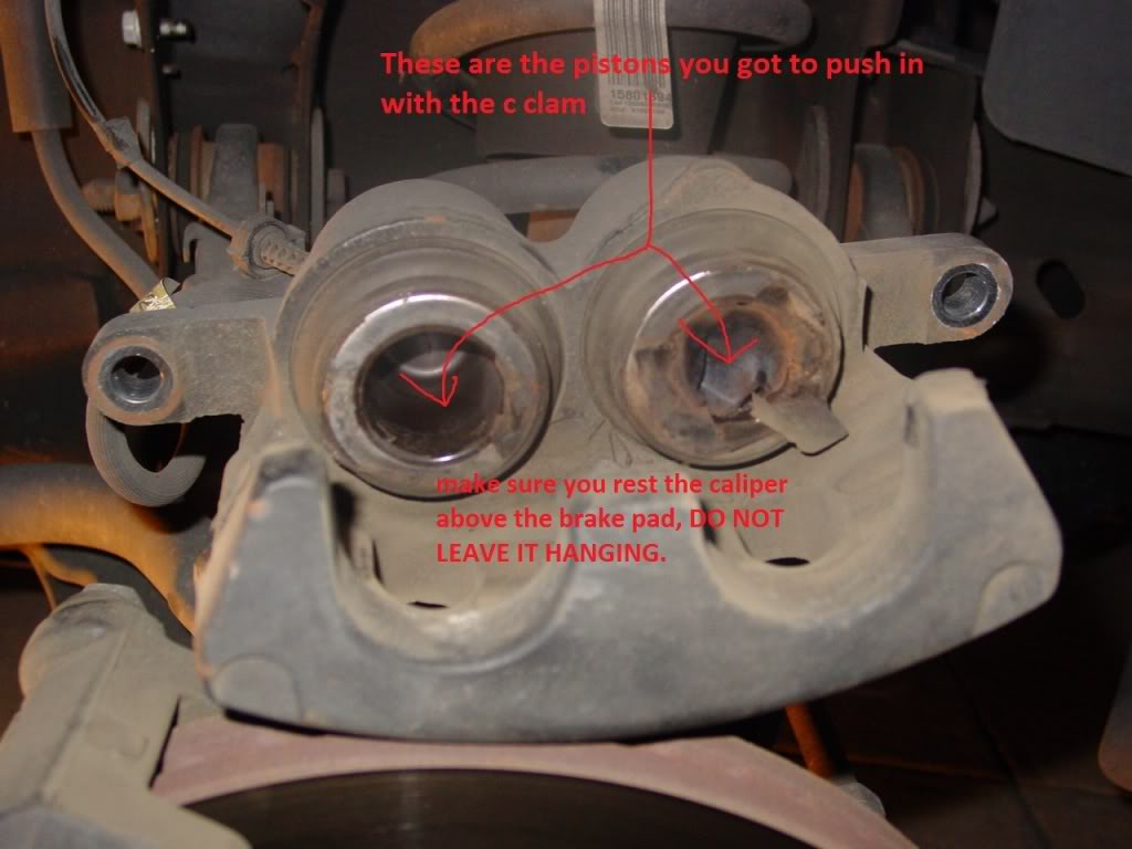

Look at your caliper, it has 2 pistons, those you got to push in with a c clamp,

Still on Step 6:
[/IMG]
Make sure all the pistons get pushed in with the c clam

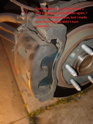

Step 9:
put the caliper back on, make sure to put back the screws, and tighten those babies good. Read the caption
[/IMG]
make sure is tight, and that's it. you're done. Congratulations you just changed your brake pads, now go to the other side and do the same. Once your done make sure that you put back the cap on the master cylinder. Make sure you have plenty of brake fluid, it needs to be at the max level.

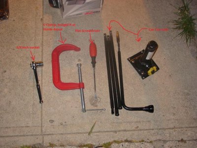

Tools needed:
[/IMG]

FWIW-I would not recommend to leave the cap off of the brake fluid resovior. Brake fluid is prone to moisure in the air just by leaving it uncaped. Great write up though!
