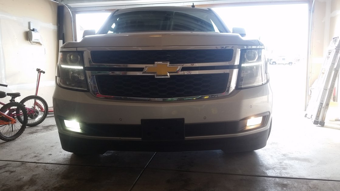

I too was annoyed by the DRLs not being on all the time with the LT. For awhile I was just turning on the parking lights but was annoyed when shutting off the car got me the annoying dinging. Running the fogs was annoying too because the color was so different from the LED strips. My solution was to swap out the halogen Fog lamp bulbs with LEDs. Now I can just get in the car and turn Auto lights off, hit the fog light button and I'm good to go. When I park and get out the lights/fogs turn off automatically. Problem solved for me and no need to risk voiding the warranty by flashing the BCM.
I bought them from VLEDS.com and it took about 5 mintues to install them. The old halogen bulb is on the drivers side.
Item Sku Qty Merchandise
5K WHITE 10 LED DRL/FOG LIGHT BULBS 5201 5202 9009 2504 PS24W PSX24W | 1 PAIR 5202_10_XB_W_5K 1 $60.00

Yes. I'm not sure if they are as bright as the LTZ DRL's but they look fine to me.
