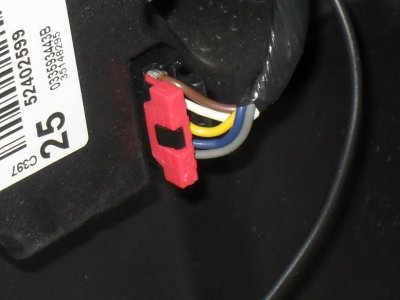

It is fixed now, it was the control module. Here is what I have, and hope it helps others troubleshoot and be able to tell which is broke without changing both parts....
# 1 Actuator controls the air from the floor to the ceiling.
• Brown wire- 14 switched voltage
• White w/black stripe- 2.5 volts. Note: when the control is moved from the floor to the ceiling, the voltages drops out to near nothing, mine reads .03 volts. Once the air has been moved the voltage returns to 2.5 volts.
• Gray Wire – Don’t know – No Voltage
• Yellow Wire- 0 volts when unplugged. 4.99 volts when plugged in to the actuator. Note: This is my assumption; that this voltage comes from the gray wire and flows back to the Aux. HVAC Control Module. Also when the control is moved from the floor to the ceiling this voltage drops to roughly 1.3 volts.
• Gray Wire- 4.99 volts both plugged in or not. Note: I believe that this voltage flows to the actuator and back out across the yellow wire back to the Aux. HVAC Control Module.
Auxiliary HVAC Control Module has 2 plug ins.
• Red Plug- This plug controls both actuators.
• Gray Plug- Guessing this plug goes back to the controls and switches.
# 2 Actuator controls the air from the floor to the ceiling. This is the actuator that is not working for me. Note: When this actuator is working properly it will turn a little bit at a time until its blending at the correct temp...
• White w/black stripe- 2.5 volts. Note: when the control is moved from the floor to the ceiling, the voltages drops out to near nothing, mine reads .03 volts. Once the air has been moved the voltage returns to 2.5 volts. Also since this actuator is not working the voltage does NOT change when the controls are changed from hot to cold.
• Yellow Wire – Don’t know - No Voltage
• Blue Wire- 0 volts when unplugged. 4.99 volts when plugged in to the actuator. Note: This is my assumption; that this voltage comes from the gray wire and flows back to the Aux. HVAC Control Module. Also when the control is moved from the floor to the ceiling this voltage drops to roughly 1.3 volts. Also since this actuator is not working the voltage does NOT change when the controls are changed from hot to cold.
I also spoke to a retired GM mechanic, he states there is also a relearning step that needs to take place after replacing any these items, which includes removing all fuses that have anything to do with the HVAC system for about 5 min. Place the fuses back in; then turn the ignition to the on position for about 2-3 min. BTW this did not work either…. I would think if you were to unplug the negative side of the battery it would do the same thing….
I replaced the actuator based on voltage levels being good, and what I read on the internet. Replacing the actuator did not work.
Ok I ordered the Control Module, and it came in today. It now works!!!
Ok here is how I am looking at it. If you test the White W/Black strip 2.5 Volts, Blue 4.99, and Yellow 4.99, and the voltage does not change when you adjust the knob/switch the look at the Control Module. If your voltage changes but the actuator does not turn, look at the actuator. If you don’t have voltage at all well then look elsewhere.
