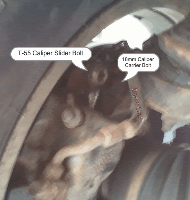

3. Use the breaker bar and T55 to remove the slider bolts. These bolts have long pins on the end that need to be cleaned and re-greased, set them aside and note the top and bottom pins. If you haven't already, turn the wheel away from the side you're working on so you have better clearance to the back of the caliper.
4. Remove the Caliper and slide the old pads out of the carrier (which is still on the truck). Hang the caliper off to the side or sit it on top of the rotor. This is where the wire hanger comes in. Whatever you do, don't let it hang solely by the brake line or you'll have a mess on your hands.
5. Using the torch, heat the bracket *around* the carrier mounting bolt, not the bolt itself. You want the bracket to expand so you can break the bolt loose. These bolts seem to be torqued to infinity, and I actually broke a 3/8" 18mm socket in half trying to remove this bolt at first. Once I had heat and a heavy-duty impact socket, it came right off. Using the deep socket allows access to these carrier bolts even with the caliper installed.

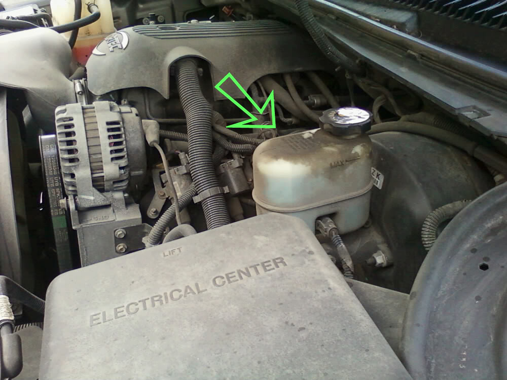

9. Open the hood, remove the cap from the brake fluid reservoir, and use the turkey baster to remove a bit of the fluid from the reservoir. We do this because when we compress the piston, the fluid will run back into the reservoir. The fluid on the top is usually pretty dirty, and we'll remove and replace a few basters full.

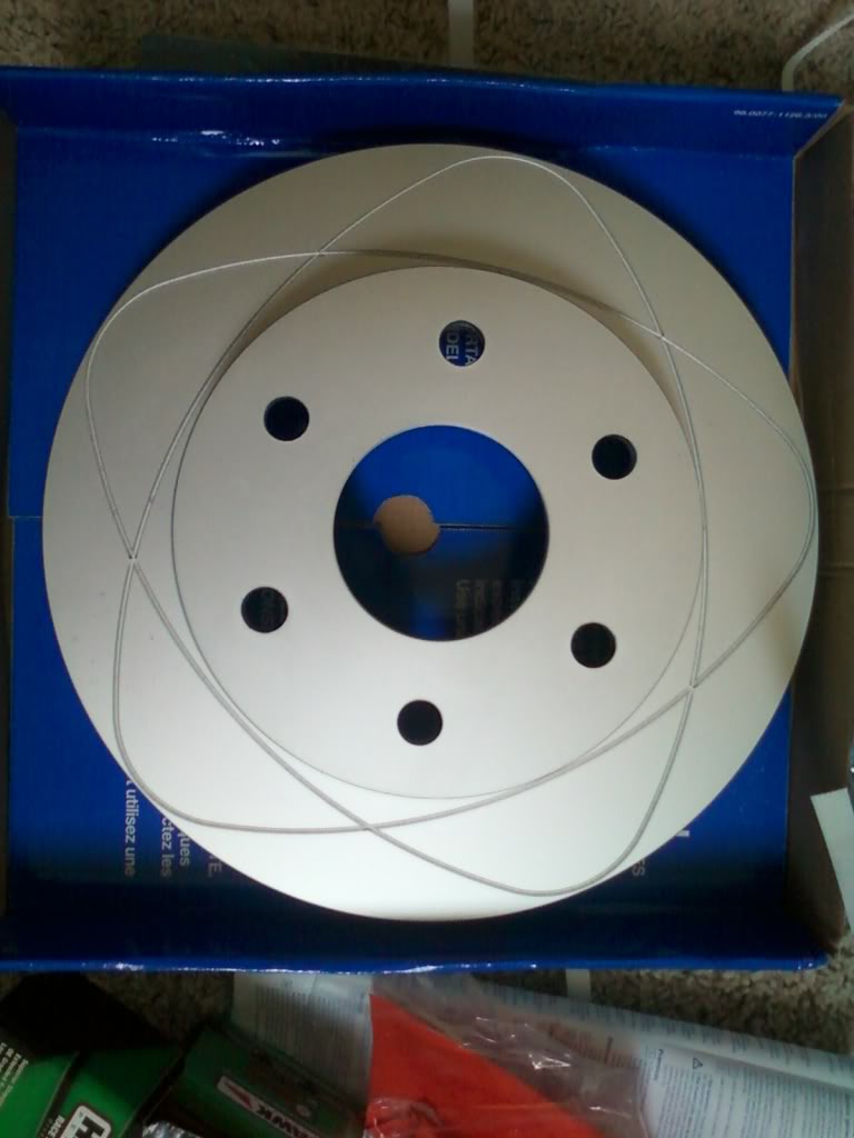

11. Take it all apart again and grab your brake parts grease. Grease all over the mating surface where the hub meats the rotor, making sure to wipe any grease off the studs. Install the new rotor (spray it down with brakecleen first to make sure there is no grease on the braking surface)
