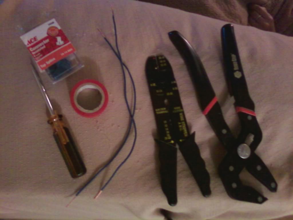

Start by gathering some tools:
12-18ga wire
appropriately sized quick splicers
a terminal
some electrical tape
pliers
wire stripper/cutter

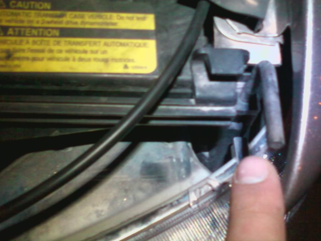

Remove the driver's side headlamp assembly by removing the two pins, just turn them 90 degrees and pull up, the headlight falls out.

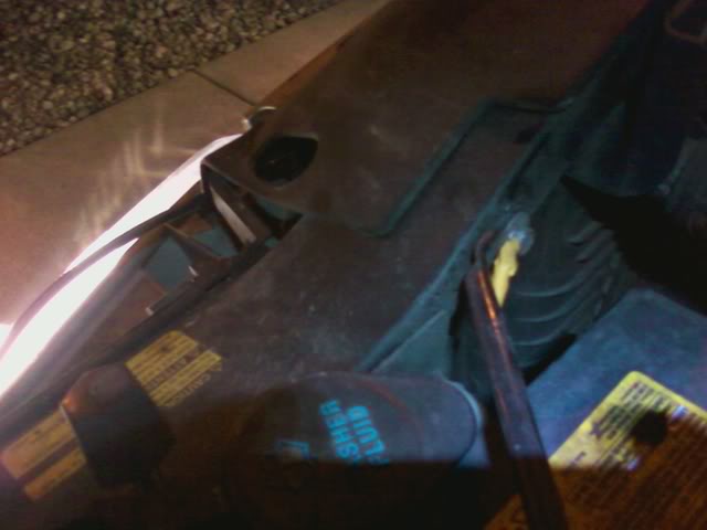

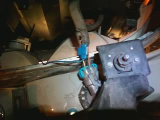

Perform the normal SUPER EASY 4-Hi Mod by splicing a wire to the ground (yellow) of the low beam, and connecting it to the diagonal brace just in front of the battery with a terminal. Cover the crimping with electrical tape to identify the wire and help prevent corrosion. Torque the bolt.
The lowlamp splice:
and its ground:

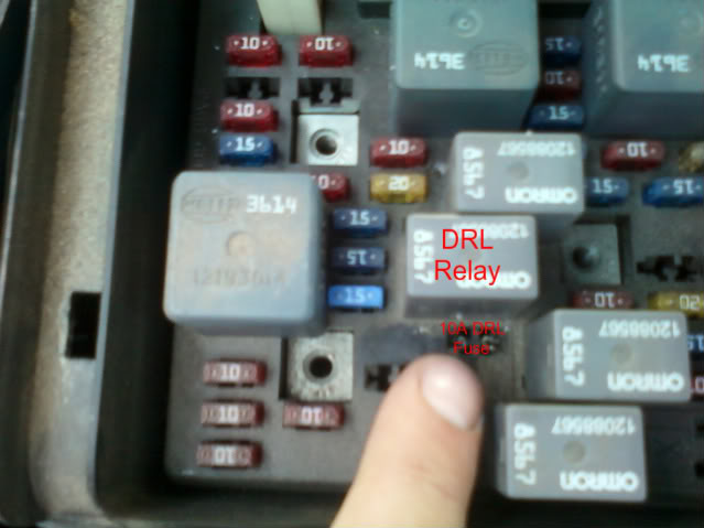

Start by opening the relay junction cover under the hood and removing the 10A DRL fuse (Image shown with fuse already removed). This will defeat your DRLs. If you don't pull this fuse, the DRLs will work initially with the LO beams until you flash the high beams for the first time with the DRLs on, which will blow this fuse immediately. I didn't want my DRLs anyway, so it was just better to remove it altogether.

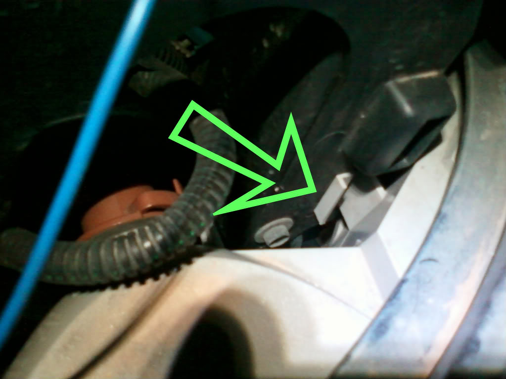

Pop out the lower DRL/Turn lamp assembly by pushing this clip and wiggling it out.

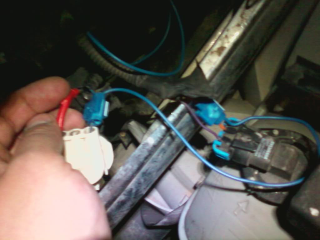

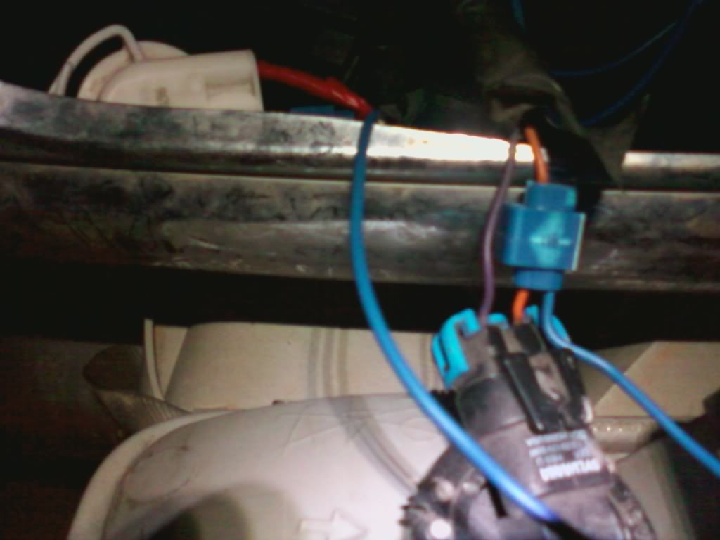

Attach a wire and quicksplice to the hotside of the highbeam assembly, the orange wire in the orange/purple pair on the highbeam of the driver's headlamp assembly.
And connect it to the dark blue (positive) wire for the DRLs. The negative is black, but I have red tape on mine in the photo.

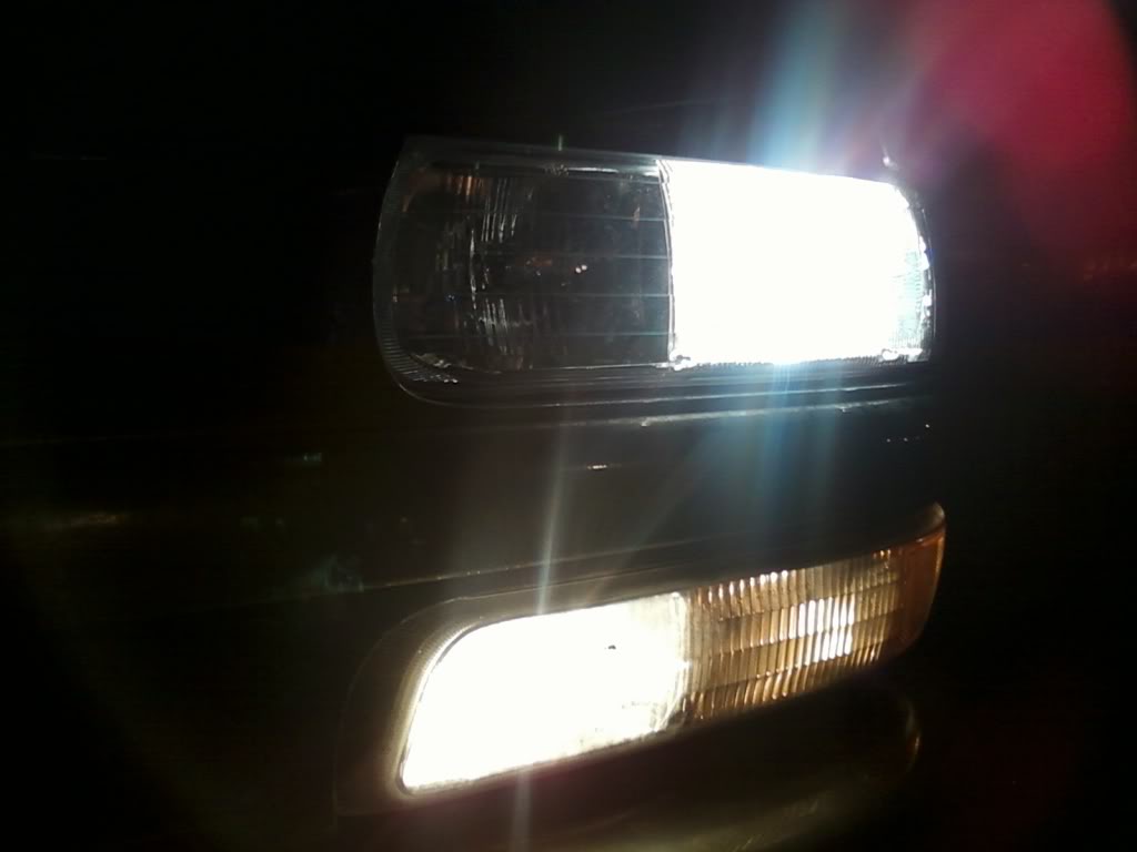

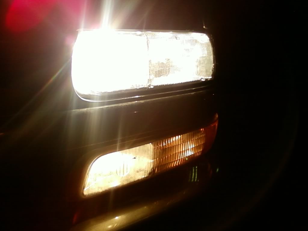

AHL and Headlights ON - 4-Lo:
High Beams ON - 6-Hi w/ DRLs:

I'm a little slow, but why are the DRL's on with the low beams in the first pic, dont they go off when the lows come on, and with your mod arent they wired just to the highs?
