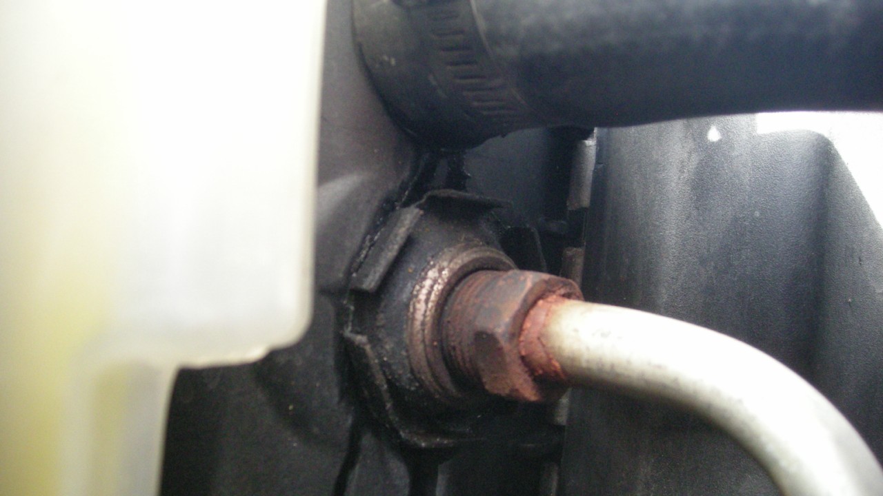

Hey guys, I stopped by Autozone to pick up a new radiator since mine has a hairline crack between the upper opening and the (i'm guessing trans cooler) fitting just below it.
They have two types of radiators there, one is just a normal radiator and he said the other was if my yukon had heavy duty cooling. I honestly have no idea and noone there could help me. Any ideas?
Here's a pic:

I always feel like an idiot when I answer my own threads, but here it is for others.
The regular is a single core radiator with a thin top profile such as this:
The heavy duty is a dual core radiator with a larger top profile like this:
It can be viewed by taking off the plastic cover over the radiator if you are having trouble discerning the difference.
