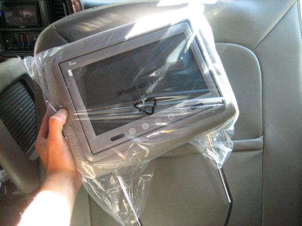

browsing ebay last week I came across this universal monitor set made by Tview. It came in 3 colors ( black, grey, tan ) and had universal headrests with 9" screen in them already. Price was $188 shipped. I decided to go ahead and try them out. For the price I figure worst case I'd have two monitors. ( ebay seller is AUDIOSsavings )
Today it came in:
Inside:

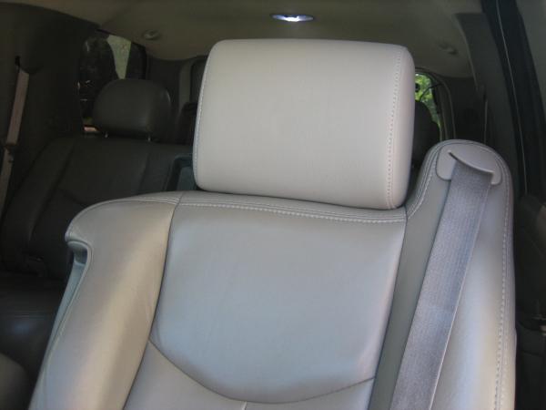

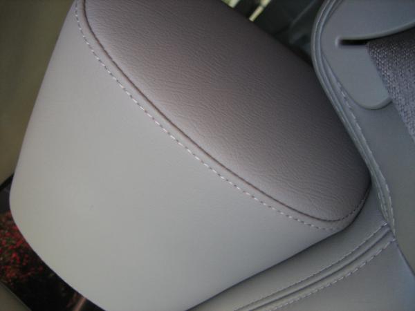

1. First Off Need to Remove the factory headrests. Start by pulling them up all the way and using two pins/paperclips/etc to release them.
Result:

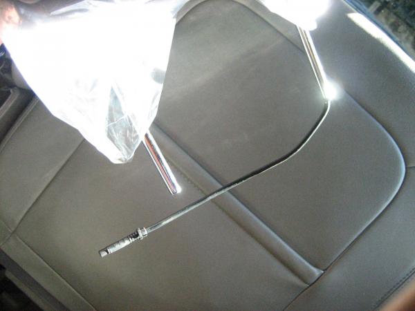

2.Now the Tview Monitor has a plug coming out of one of the bars, you're going to fish that through the hole first then lock the headrest all the way down.

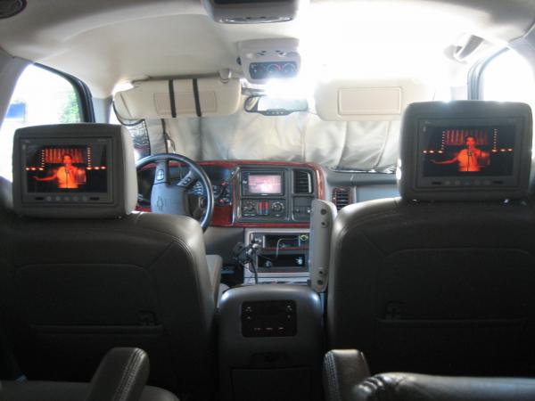

5.Connect the power to some type of ignition power and ground to ground, then connect whatever video/audio inputs to it and you're done!

Overall I'm pretty happy with them, the color isn't too off, the texture is different, but for the price I'm not too worried about it. The picture clarity is pretty good as well. The buttons are easy to press and there's a "beep" whenever something is pressed either on the screen or the remote. Each remote only operates one monitor. And the IR transmitter is a plus, so in the future I may purchase wireless headphones to use with another DVD player in the back only.
