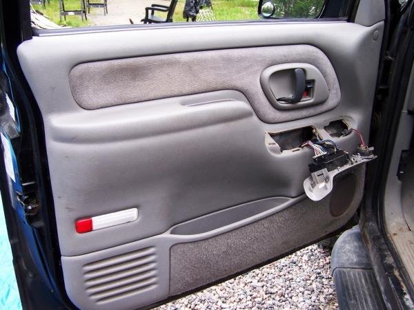

1. Pop up the panel that contains the windows switches from the rear by the door pull handle.
2. Use a small flat screw driver to carefully remove the electrical connectors and place switches in a safe location.

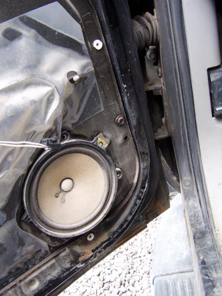

3. Use the 7mm socket and ratchet to remove these two screws and move them to a safe location.

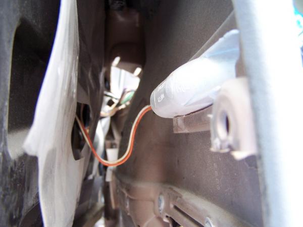

5. Carefully pry back the panel enough to remove the electrical connector to the door light.

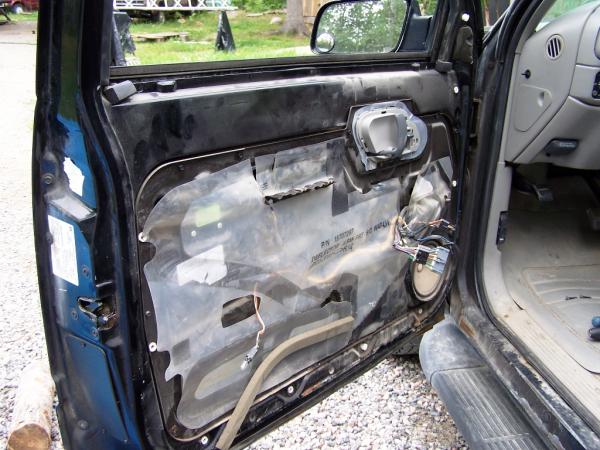

7. At this point you can pull back on the door panel, and carefully lift it straight up and off the door. Put the door panel in a safe location.

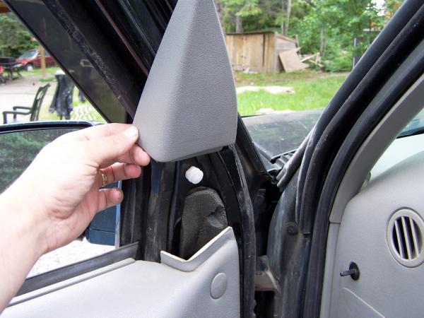

8. Now survey your door and see if you can find out where the squeek or rattle was coming from.
For me it was here!
the missing peice of plastic insert.

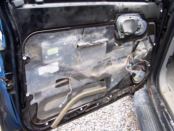

9. Now seperate 9 plastic clips into their two parts.
10. Remove the old plug receivers and insert 9 new ones. If you are missing any original peices, don't worry the holes are pretty easy to spot and each door takes 9 clips.

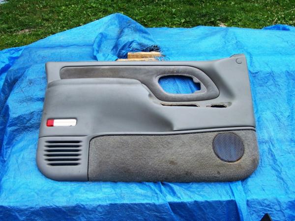

11. Remove the old plugs from the door panel and insert 9 new ones!
12. While you are there and you have the door apart, why not take this time to clean the door trim peices and the carpet of the door panel, etc.
