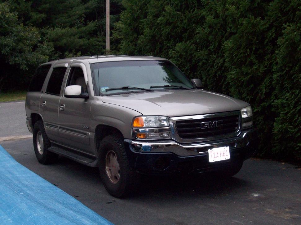

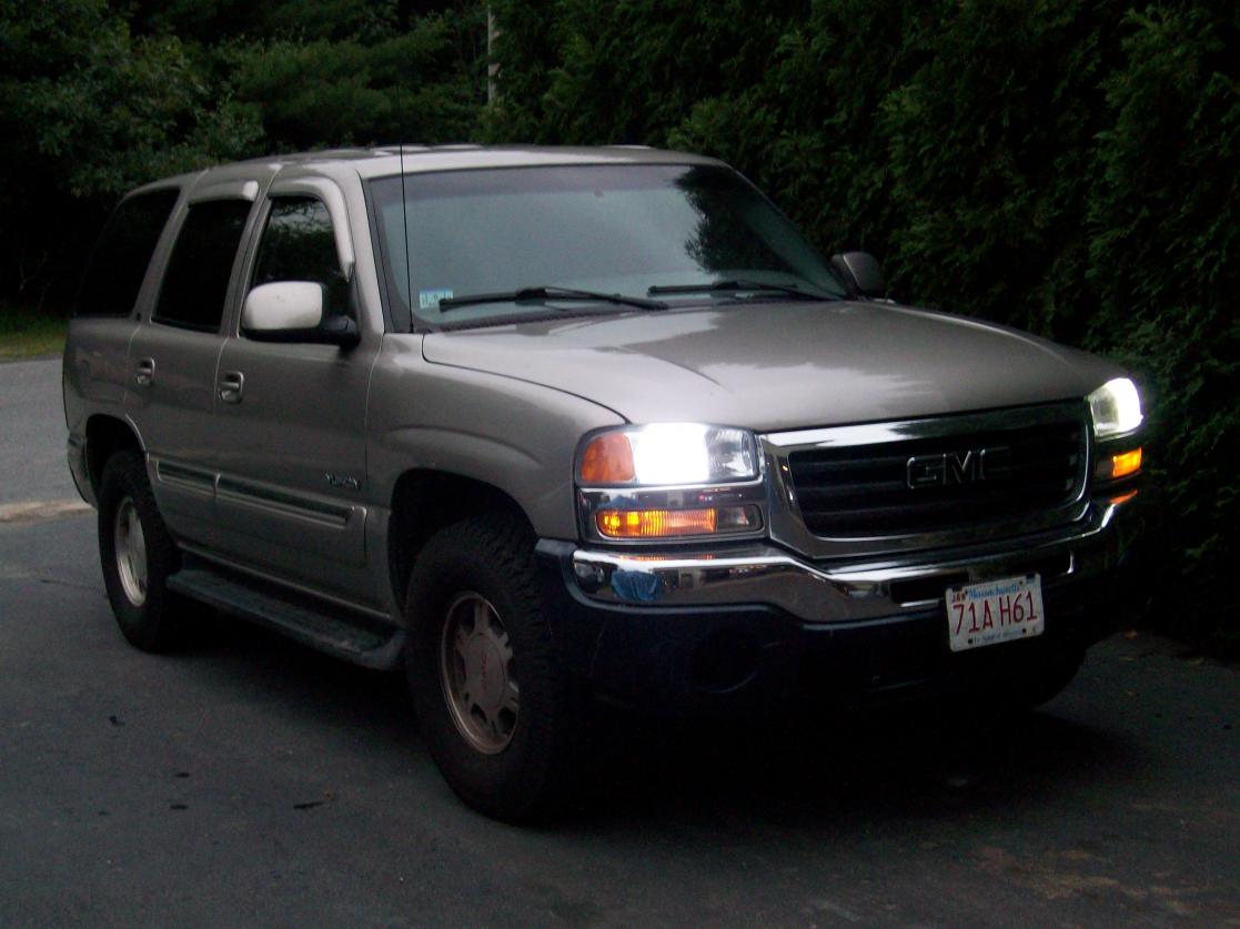

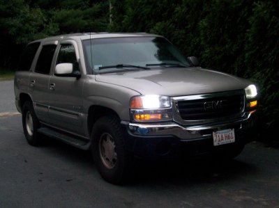

New here, figured I would start off with something useful.
Did the swap using 2005 Sierra 2500 HD stuff. Cut the HD spacer off the grill, cut all stock bumper brackets off the Kon. Took it right down to the frame rails. Ended up using the Sierra 2500HD brackets (re-drilled and raised) and using the 2500HD bumper support brackets (flipped to oppsite sides)
Anyway, came out pretty good, have a new valence on the way, threw up the junk one for looks. Definately harder than it looked. If I did it again, I would investigate Sierra 1500 brackets.

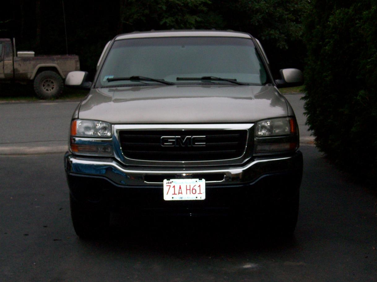

Been a while guys, sorry. Tint is done, Bumper painted, running boards removed, and just put on a set of tow mirrors tonight. They are the smaller towing mirrors for now. Just need to find a pass side large mirror and I'll swap them out.
Pics later this week. Too dark tonight.

Looks pretty good. Different. Those mirrors arent bad looking either. Not to big. Need some fogs id say though..
