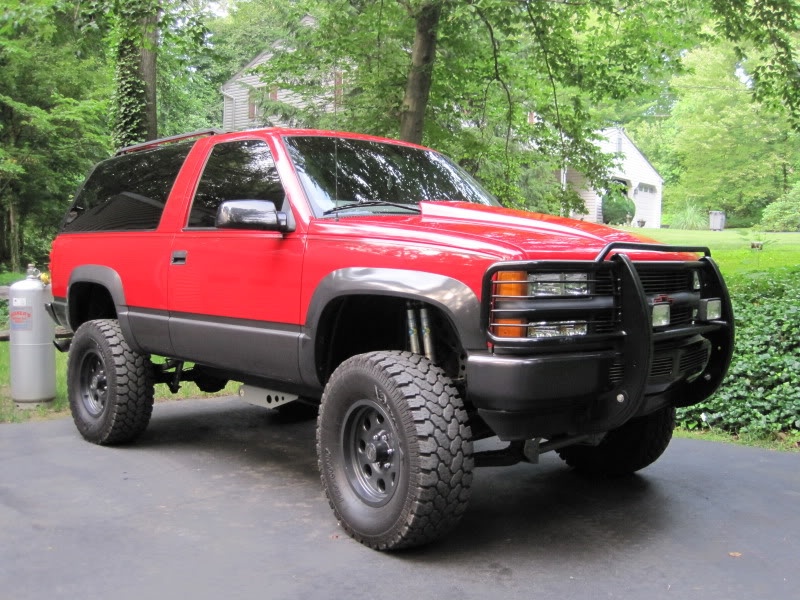

There are always threads asking about pictures of x amount of lift with xx tires. I see this on other forums and we need it here. So anything from cranked torsion bars with blocks out back to a body lift or suspension lift.
So post the specs about what you have on your suspension and tires and attach a picture. This should answer some questions and maybe help steer some guys to the correct setup right off the bat.
6.5" DC (Extreme suspensions) cranked to about 8" in front
6" Procomp springs out back
Bilstein 5100 series at all corners, dual up front
35"x12.5x17 Procomp Extreme AT tires
17x8 ATX Mojave wheels (teflon coated)
4.56 Yukon gears with Trutrac
Tom Woods CV drive shaft in the rear
Fenders Flares sit at about 45.5" in front, 44" in rear
CV angles

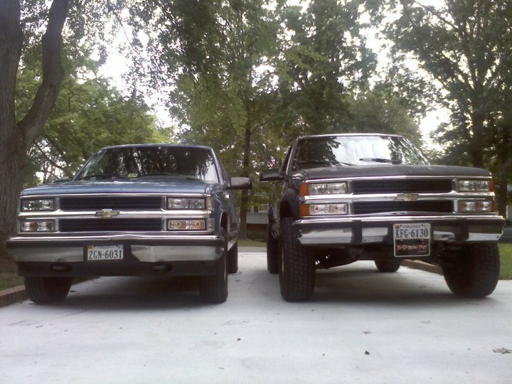

I have a 3 inch body lift with 2 inch blocks and a crank on 285's. It's not much but it's better than nothing.

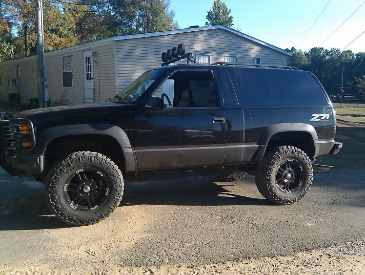

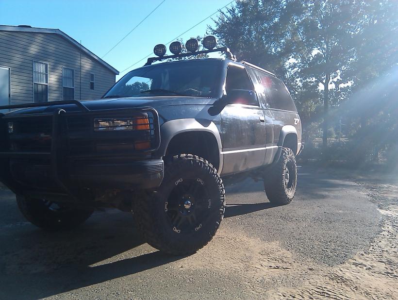

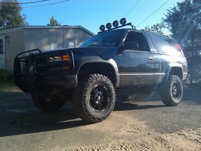

3" Body lift
33" Nitto Terra Graplers 12.5" wide
17" XD series Addict wheels I cant remember the offset but they are 4.something
Small Hoe :( but shes mine!

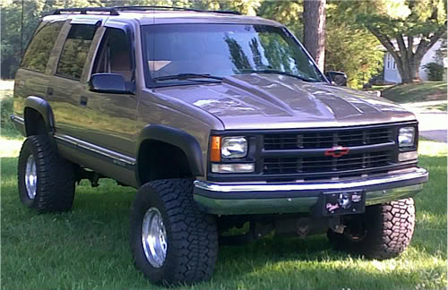

everyone should kno my set up by now!!!
6inch pro comp
im sittn at 44in in the front and 43 in rear (also i have 35's that are bald and measures about 33 so once i get new ones ill be a little higher)
15/10 rims (not sure the brand)
on 35/16.5/15 super swamper's (hate if u want but its a DD and does amazing off road!)
supper 44 flow master single exhaust
hypertech chip
4l60e borge worner clutches and transgo stage 3 shift kit,
383 auburn gears with a eaton posi
rhino liner floor
flat black paint
cold air intake!
clear head lights and markers with 5k HIDS
im sure i forgot something!
