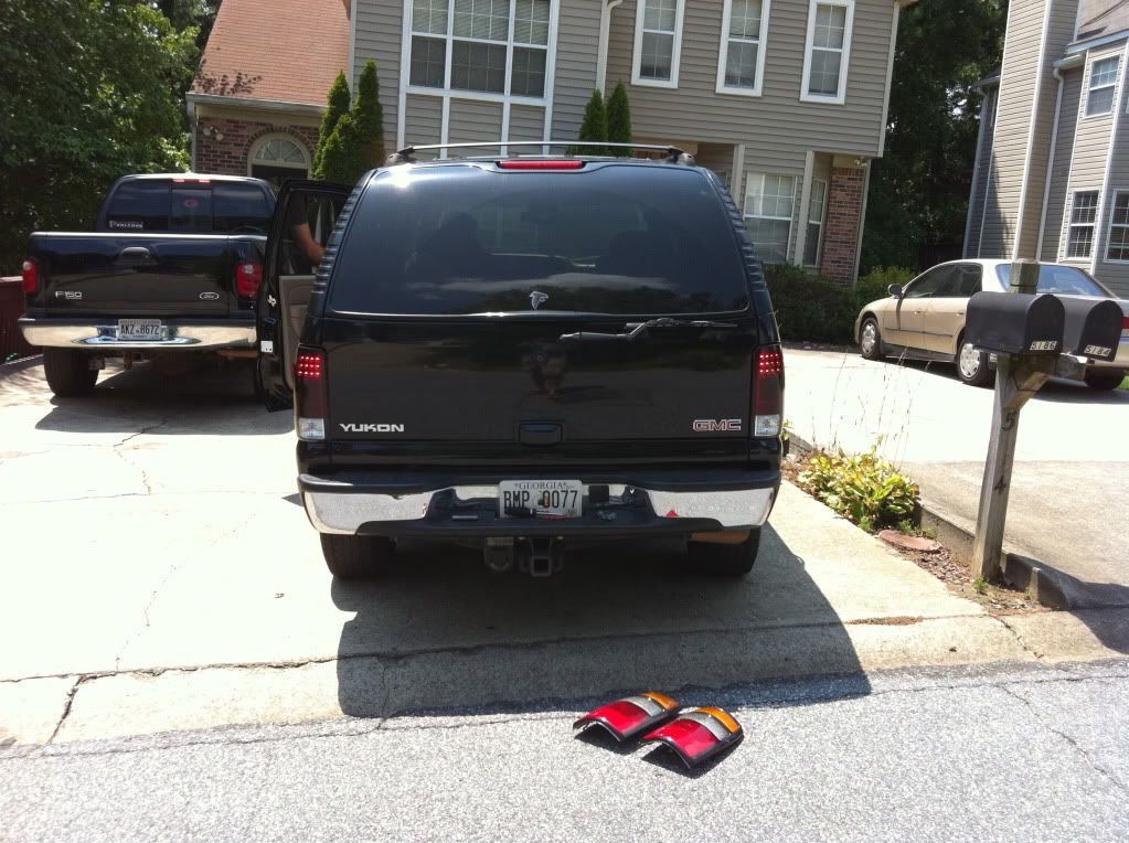

I bought these tail lights from l.downen on the board, i'm sure a few of you saw them, they were completely black. I couldn't see through them at all. I started by trying to sand them down hoping the VHT would get a little more translucent since i want them smoked anyway. But it seemed as if i was getting no where with 800 to 500 grit paper so i went searching for another method.

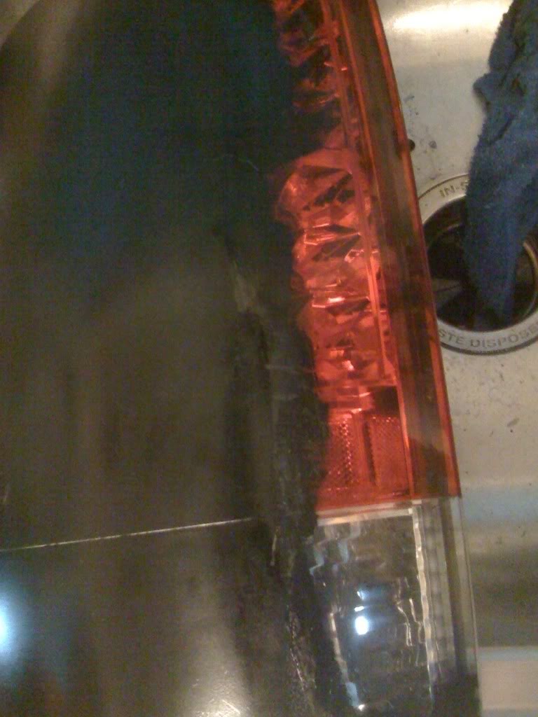

Took some trial an error with the first light but i had it down by the second. I started in the middle of the light and poured a generous portion on the light. Gravity takes it down both sides of the light which help as you move outward. I would pour it on, let it set for 30ish seconds then i had a plastic putty knife and scraped it off. It was much more effective. Once the majority of it was gone i would pour some goo gone on my towel and rub until clean. Here is the first light where i started on the right side.
You can see how thick it was. ended up going through a few rags and an entire small bottle of goo gone.

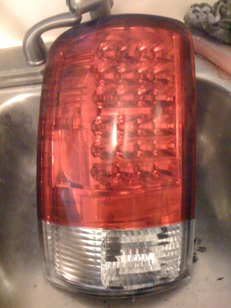

After i finished
After i got all of it off i used some plasticX to polish and remove wahtever residue was there.

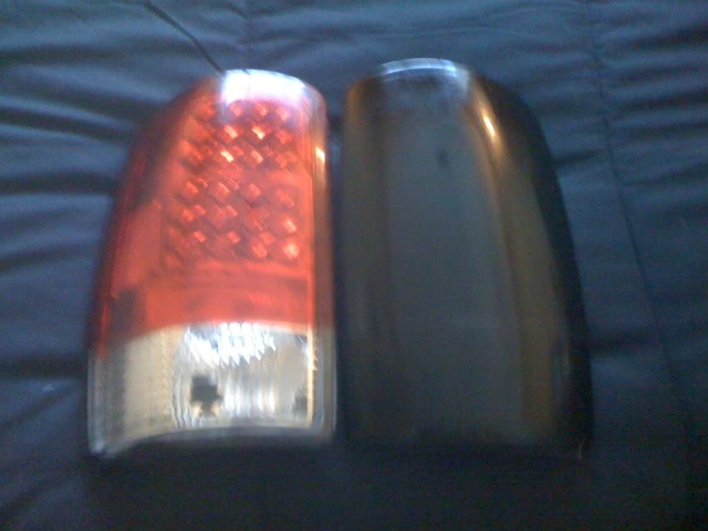

Crappy cell phone picture of before and after....
