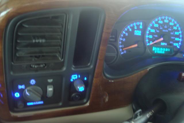

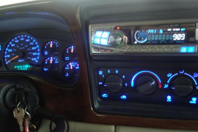

Here are some before and after pics of mine.
Before:
After:
And here are some more after shots to show how they match the rest of my blue interior LED's that I did:
