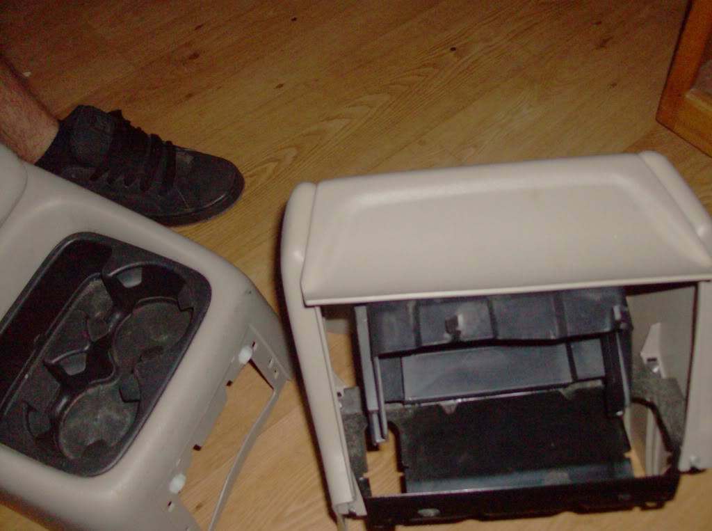

So here it is... It was shea in color no mounting bracket, no Electronic components.
After removing about 12 or so screws, its completely part.

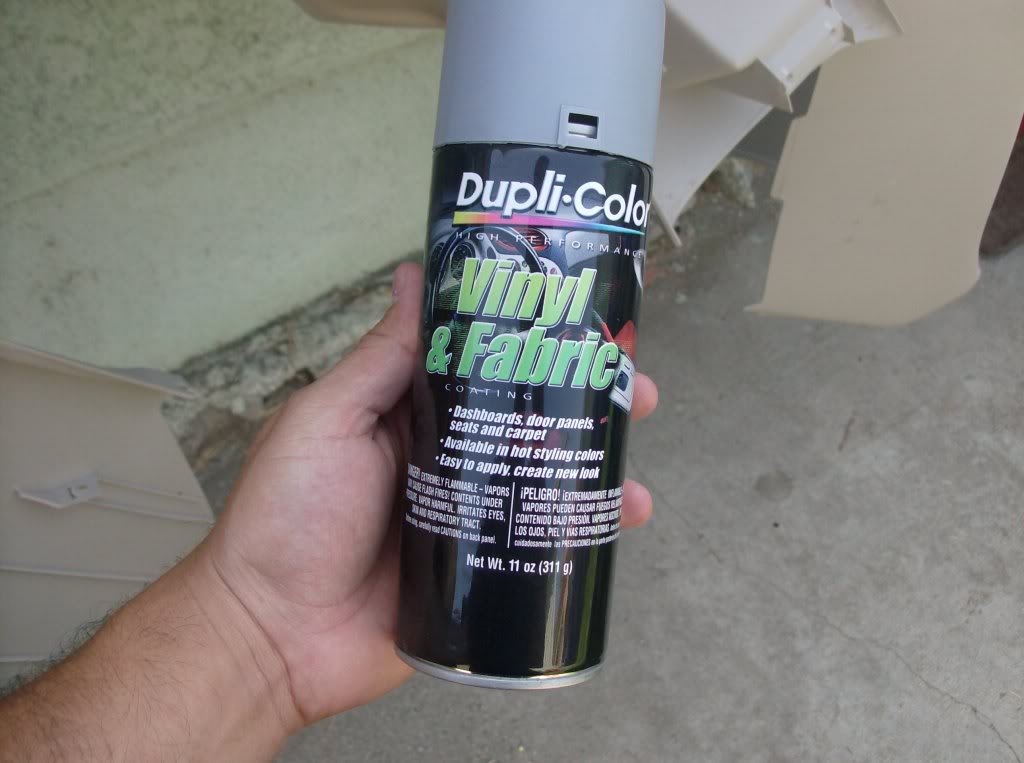

I placed all the plastics in the tub and gave them a good scrub with some dawn dish soap. this is an important step before painting.
Here I simply hung these pieces up with sum fishin string.
I used 3 cans and put on 3 coats, this stuff worked great and its very inexpensive and its available at any auto store.
