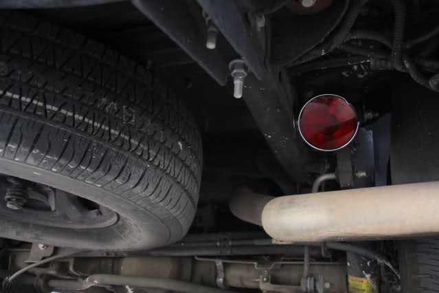

here are the tail lights i got, i love them, but they dont seem to be on ebay anymore
this is the mod i added afterwards to solve the loss of cruise control. i did this because its cooler than getting an equalizer or resistor, lol :secret:
yeah, what the hell are those, do they stop the rapid blinker?
