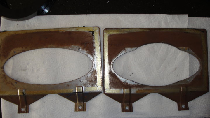

In the rear 4x10 location, it is true you can dremel it out to accept a 6x9. I've done so and installed Alpine Type R 6x9's which have a large magnet and basket. Make sure you get a pack of cutting wheels for your dremel as the steel bracket will eat them up (think I used 3 or 4 of them). The trick to installing deep 6x9's like this is getting an angled 6x9 spacer which will help in a few ways:
  1. Will give room for deep speakers that will produce better and fuller sound, especially when ampliefied.
  2. Fill further angle the speaker towards the front of the cab for a better sound stage.
  3. You won't have to dremel as much of the speaker mounting bracket due to the spacer being installed.
I can show you pics of the work if you want. The spacers can be found on eBay or Amazon for ~$10-15. Can't help with the other questions.

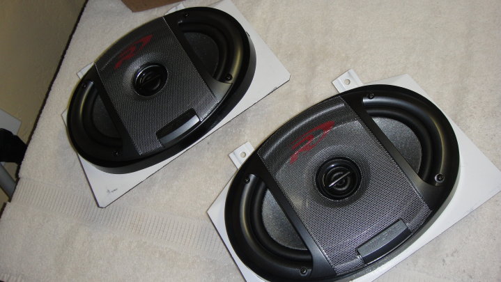

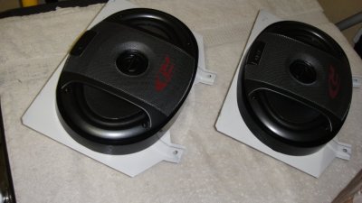

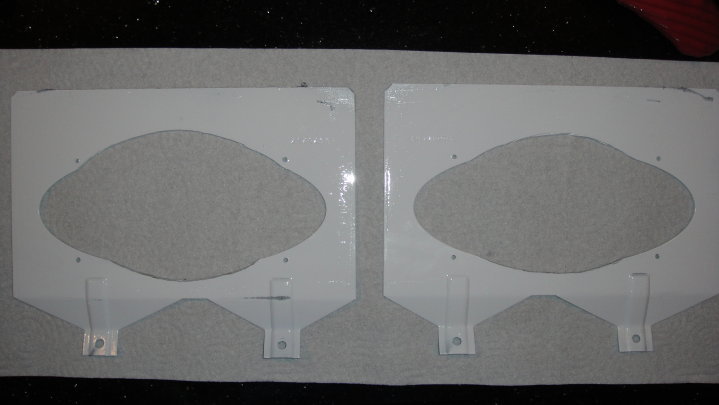

Here are some pics of the work. You can see how much needed to be dremel'd out and see the spacers, which you can see aren't anywhere near 2". I also used some of the Fat Mat Rattle Trap on these brackets that I had left over from doing my interior which helped isolate some of the sound the brackets create, but it doesn't look like I was able to find any pics of the finished work.

Thanks for the pics. I am going to try the 6x9's real soon but for now I am going to amp the four 6.5's and see what happens. The make or break deal for me with the 6x9's is they have to fit under the stock speaker covers.
