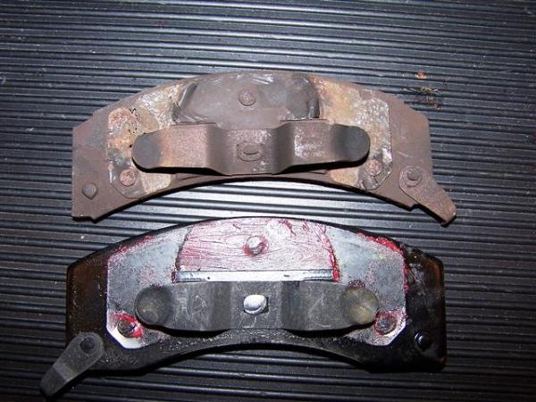

Did u have to modify the 3/4 pads to fit the rotors.. I'm looking at doing this upgrade too but from what I've read the 3/4 don't fit without grinding away extra metal...
S
sparg93
Expedition Tahoe
Dec 1, 2009
1,284
NJ

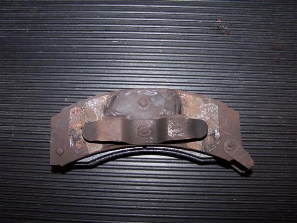

Yes - you have to grind the backing plate on the pad....but it's really easy (you will need some form of tool to do this - i used a stationary grinding wheel)
There is a plate on the back of the brake pad that is used for mounting the pad within the caliper. This mounting plate will rub the tophat on the rotor if you install "as-is" on our 1/2t setups.
Simply grind the inside of the mounting plate so it's flush with the pad material...essentially your grinding away the part of the back plate that sticks out below the pad material.
It takes <5min and as soon as you get the pads you will know what I mean if my description makes it hard to visualize.
The best part is the 3/4t calipers mount directly! I highly recommend AC Delco's remanufactured. I was VERY happy with my set and they honestly looked brand new and came with all the hardware and lube.
