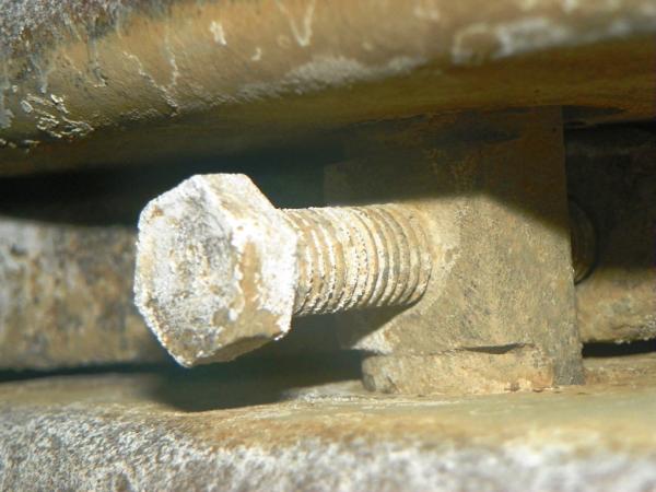

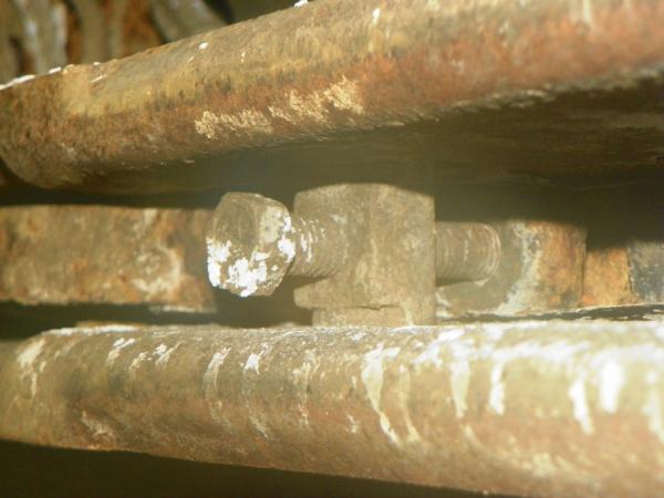

Hey BowtieFreak, is that 35.5" on your suburban completely stock? Just curious because I had to crank on my t bars to get 35.5" on my 2 door.
The PO of my Yukon obviously didn't know much, because one of the t bar key bolts was backed off a whole lot, and the drivers side sat about an inch lower than the passenger side. I've got it nice and even now at 35 1/2".
If thats stock, I'm excited cause than means I can crank it up some more without getting too close to the stops.
