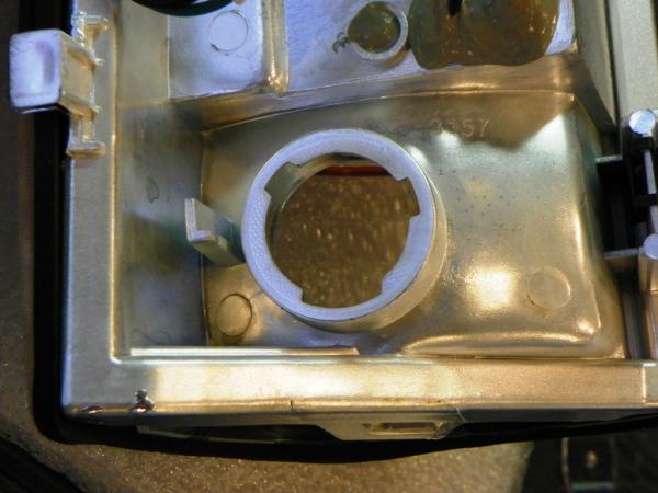

Then I took apart my stock taillight housing to discover that they used a circuit board that blocks access to the bulb holes. After removing the circuit board and rummaging through our auto shop bins, I found some new pigtails that would friction fit into the holes, but a test fit in the truck revealed that the pigtails were too long and prevented the taillight housing from fitting without cutting holes into the fender. I didn't want to do that. (I described that process HERE.) So I looked into aftermarket tails. I ended up buying some ANZO G2 LED tails.

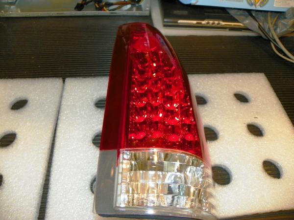

1. Drool over the drop dead Gorgousness of your new Taillights.

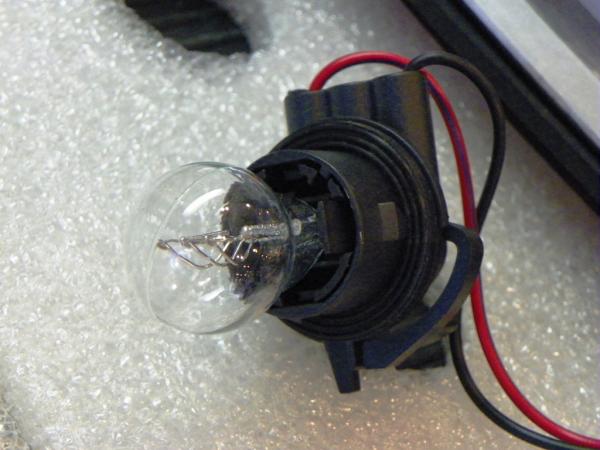

2. Remove the electrical pins that go into the stock reverse bulb pigtail. Throw out extra bits that are removed here. We need those electric pins to power the HIDs.
Flip it over and drool some more.
Twist the pigtail out from the taillight.
Pull the bulb out. It comes straight out.
Remove the inner socket from the pigtail, two clips and they pull out. I used forceps to pull them out.
Remove the electrical connections, they just pull out now.

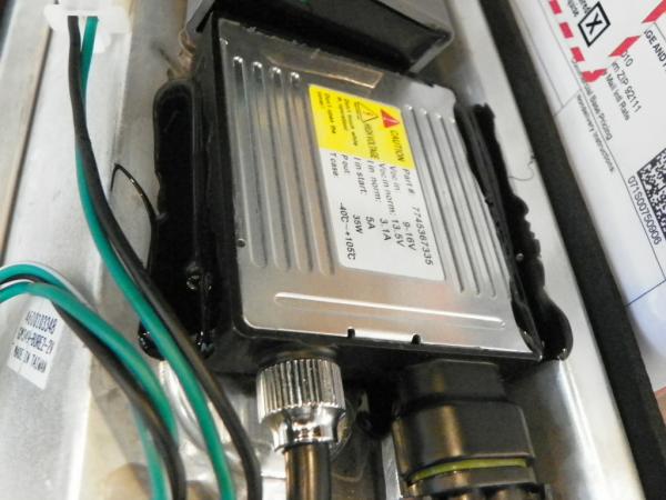

3. Using the black GOOP, goop in the ballast to the rear of the taillight housing.

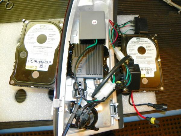

6. Do the wiring. It's pretty easy, the DDM HID wiring is keyed so it can't be messed up. And the cool part is that the power leads from DDM kit match up with the power leads of the reverse bulb from ANZO. The only problem is that they are not covered and are bare, so I wrapped up mine good with black electrical tape. black goes to black, and blue goes to green. Can't mess it up and it works first try.
7. Install onto truck. I didn't have enough room for everything behind these lights. The black small box of the HID wiring had to be shoved into the existing hole in the fender with just the wires sticking out.
