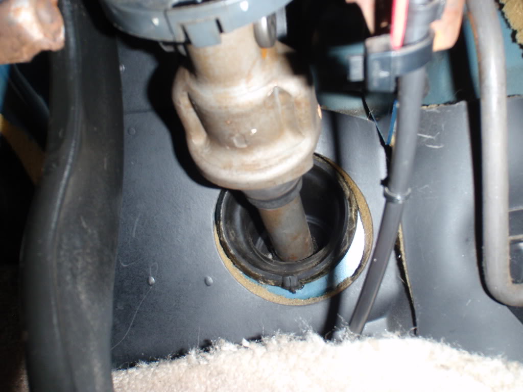

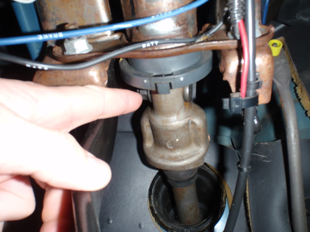

Its really pretty easy. First you will need to undo the nut and take the bolt out.
After removing the bolt you will have to slide the steering shaft into the firewall about 2-3 inches to separate the shafts enough to slide the sensor off.
Make sure to release the 3 tabs before trying to remove the sensor. They will break if not removed. Then simply slide to sensor off the end. You will have to follow the wires up to find the harness to unplug. Unplug the old and plug in the new. Now reverse the process and enjoy much tighter steering.
In the pics as you can tell I wasnt switching mine, but just pointing it out. Another this too, make sure to lock the steering wheel before starting. Hope this helps!

Thanks for posting up the pics and instructions. I think it's a good item to replace. Our trucks are old and reliable steering would be a good thing!
One part that I'm a little bit confused about is; where that nut and bolt is, does the steering shaft come apart there? And it's the bottom part of the steering shaft that has to slide down a few inches?
Ok, so now onto the really stupid questions... Is there a danger of the bottom part of that shaft dropping down through the firewall? Do I have to hold onto it all the time so it won't slip? Is there a danger of accidentally rotating the bottom half 180degrees so that it might go back together backwards? Or is it pretty hard to mess up?
Sorry for the questions.
fyremanpat
Fyremanpat
Feb 4, 2010
478
757
No its cool. Its on the steering shaft inside the truck, you cant miss it...Yes that is where it separates, and yes the bottom part slides into the engine compartment through the firewall. No it wont slide down to far (its kind of hard to move it actually) No it wont rotate but do make sure your wheels are straight.
