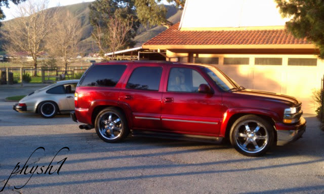

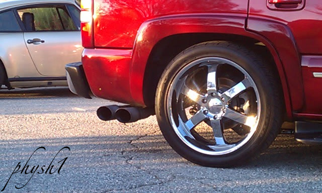

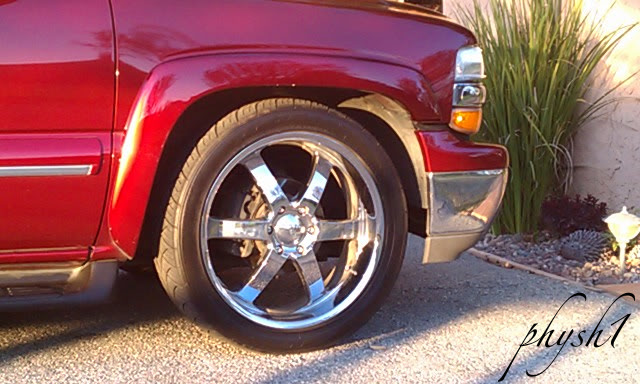

Here's my setup & a possible template to work off of...
Model/Year/2x/4x/AWD:
- 2003 Tahoe LT 4x4
Advertised drop:
- 3"/5.5"
Fender height front/rear:
-31.75/32.25
Front:
- LCA's : DJM 3"
- UCA's : stock
- Spindles : stock
- Sway Bar : BellTech
- Tie Rods : Custom 1" DOM w/ 3/4" chromoly teflon lined heims
- T-bars : stock
- T-bar keys : stock
- Shocks : DJM
- Steering : KYB stabilizer
Rear:
- UTA : C3Fab adjustables
- LTA : C3Fab adjustables w/ DJM relocator kit
- Springs : DJM 4" Trailblazer
- Panhard : Spohn adjustable
- Sway Bar : BellTech w/ DJM end links
- Shocks : BellTech
- Air Assist : None
Wheels & Tires:
- Wheels : 22" Boss 330's
- Tires : Nitto 275/40/22's
Considered upgrades:
- DJM uppers to ease UCA balljoint angles. Noticed occasionaly popping from stock upper joint. Otherwise, nothing.
Brief impressions of setup:
Overall, the ride is firm but not stiff. The suspension has a progressive rate feel to it. Normal driving it's really
tame but it takes corners incredibly with little to no body roll & my confidence is gone long before any talking from
the tires.
Pics:
Good idea? Bad idea?

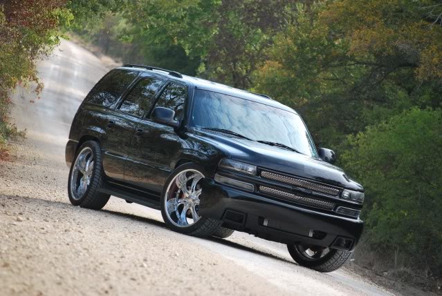

Tahoe What's Stance
- 2005 Tahoe LT
Advertised drop:
- 3"/5"
-32.00/32.00
Front:
- LCA's : stock
- UCA's : stock
- Spindles : Mcgaughys 2" drop
- Sway Bar : Eibach
- T-bar keys : Gone
- Shocks :QA1 Coil Overs (custom brackets, etc) No more Tbars
Rear:
- UCA: Spohn adj.
- LCA: Spohn ajd. w/ Mcgaughys relocator kit w/ endlinks
- Springs : Beltech 5305
- Sway Bar : Eibach
- Shocks : QA1 adj.
- Free Travel Mod - Yes
Wheels & Tires:
- Wheels : 20" GM SS chrome rims
- Tires : 285/50/20 Nitto420
Rides good for being lowered. Firm setup, but handles 100x better. (with old setup)

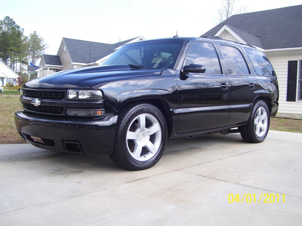

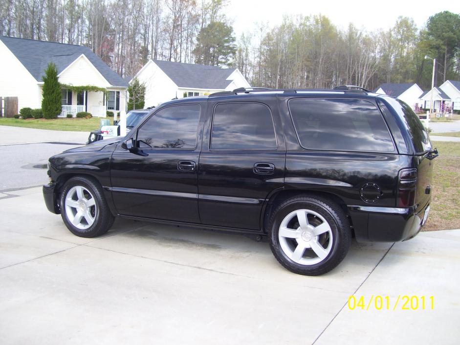

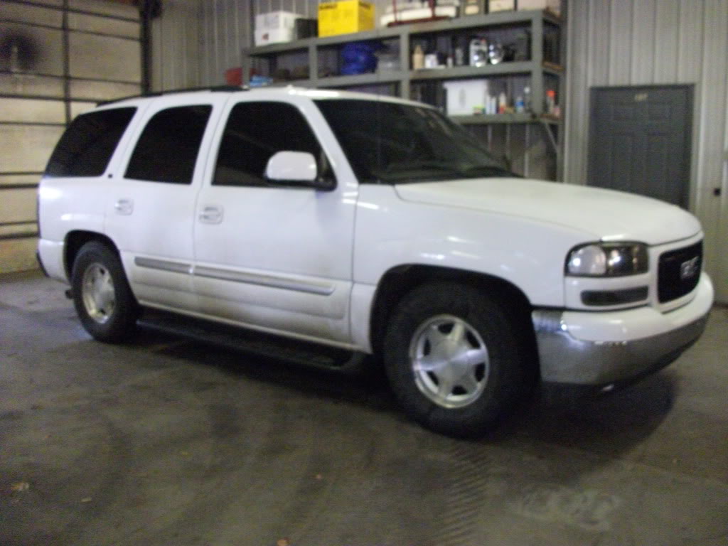

2001 Tahoe LT 2wd
3/5 advertised drop (but closer to 4/6)
Front:
2" McGaughy's spindles and keys
Rear:
DJM 5" coils and shock relocation brackets.
Shocks:
Bilstein HD
Wheels/tires:
24x10, 305/35/24
Ride quality:
My wife is okay with it.

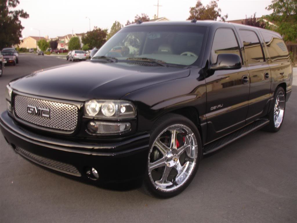

- 2003 Denali XL
Advertised drop:
- 2"/3"
-33.75/34.5
Front:
- LCA's : stock
- UCA's : stock
- Spindles : stock
- Sway Bar : stock
- Tie Rods : Congito kit
-T-bars : stock
- T-bar keys : belltech 2" turned down a little
- Shocks : stock
- Steering : Cognito stabilizer
Rear:
- UTA : stock
- LTA : stock/read DJM hardware kit
- Springs : slam bags
- Panhard : Stock
- Sway Bar : stock
- Shocks : shock extenders with factory shocks
- Air Assist : firestone with manual paddle valves
Wheels & Tires:
- Wheels : 24" Giovanni Abruzzo's
- Tires : BFG KDW 305/35/24
possible lower with Tony's kits or full airride
its the wifeys DD she like it just the way it sits I wanna go lower but who knows we will see.
Pics:

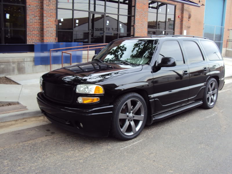

- 2002 Yukon Denali AWD
Advertised drop:
- 4"/6"
-31.00/31.50
Front:
- LCA's : stock
- UCA's : stock
- Spindles : Belltech 2508
- Sway Bar : Eibach 35mm
- Tie Rods : Illy Napa Premiums
- T-bars : stock w/Tahoe Z71 Bumpstops
- T-bar keys : 3/4 Ton Purple Keys
- Shocks : Bilstein HD OE Replacement Front/Bilstein 5125 21.54" Extended Length Rear
- Steering : Fabricating a Dual System
Rear:
- UTA : Stock
- LTA : Stock
- Springs : Belltech 4" Trailblazer 4230
- Panhard : Spohn Adjustable
- Sway Bar : Eibach 32mm w/Jeep Wrangler JK Links
- Shocks : Bilstein 5125 21.54" Extended w/Belltech 6651 Extensions
- Air Assist : Airlift Helper Bags 60748
Wheels & Tires:
- Wheels : 22x9 Gray TBSS
- Tires : Nitto 420S 285/40/22
- Stock Keys decranked or DJM Arms because they're the only thing I haven't tried on this vehicle.
Trucks drives nice but is a bit stiff, comes with the territory being this low. The truck handles amazing for such a heavy vehicle. I have no issue pushing it hard through tight mountain roads faster than sense would dictate. I'd contribute much of the handling to the lower center of gravity, quality tires, and most notably the gigantic Eibach sway bars. The spohn panhard was an excellent upgrade and I'm considering some adjustable rear arms to center the wheel. Pinion angle for the rear axle is money though.
Pics:
