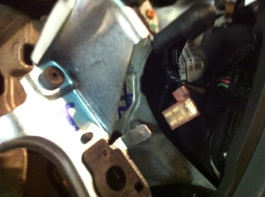

Remove the four large nuts with the torc 30 bit, they will not come apart from the main bracket.
Then disconnect this wire.
Here is what it looks like removed.
Remove the four ground contacts for the horn.

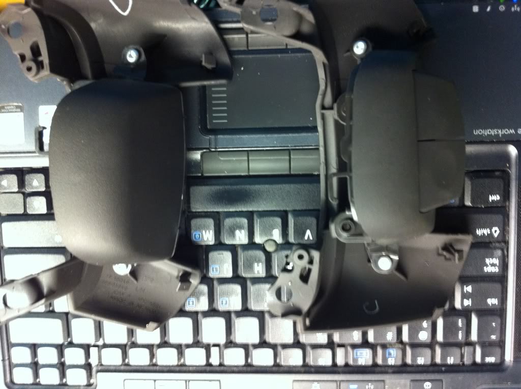

Then remove the radio and cruise control controls if you have them. Then reattach them to the new trim pieces.
Should look like this.
Reattach the trim pieces.
