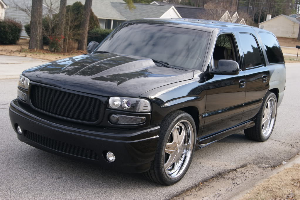

yes it can be done, 2 ways you can do it buy the entire bumper hardware or just buy the cover and make it fit which consist of a little trimming of your bumper,i have done thios and is not hard here is a pic, let me know if you got more questions

Thank You CARCRZ, ........ If I decide to do just the Cover, when purchase will come with hardware or will use my existing one?

when you buy the cover thats all you going to get no hardware, but you dont need none all you will need is to trim your bumper and 4 screws to screw the cover to your bumper and thats about it its real simple.

so unlike what the other threads ive been reading. all i need it to mod the denali bumper to fit over my stock bumper. and i dont need all the brackets n crap

you will need to modify your factory bumper to fit the denali cover. but no, you dont need all the hardware. no unless you want to do it like oem. but i went the cheap way out and just trim the oem bumper. and it looks and works just fine

Looks good carcrz
MSanchez - Plus the grill since it is different than the regular Yukon.
