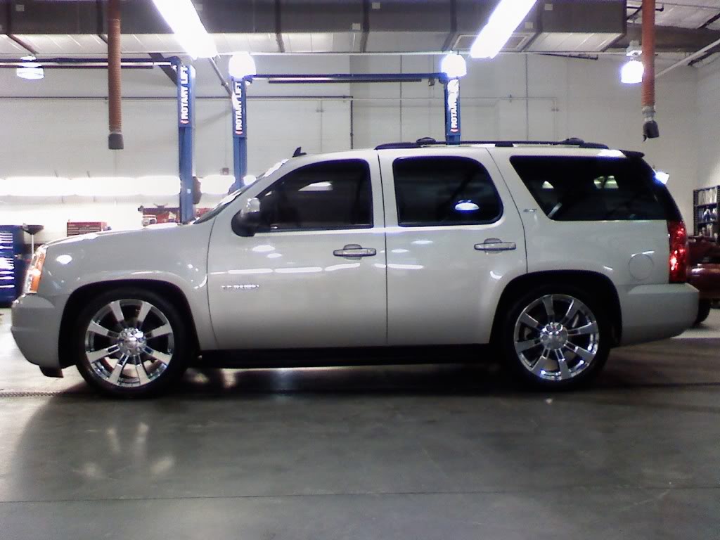

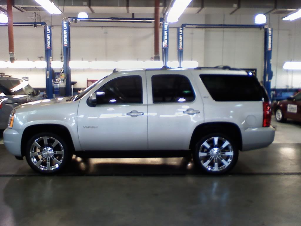

Kit consists of
Front djm 3 inch upper/lower a arms
rear djm hardware kit
rear djm tb springs
rear belltech shocks
BEFORE
AFTER

Looks good but he does not look as low as me for some reason. My quarters are only about 1.5" off my rear tires, reason why I can't do the free travel mod.

Looks sooooo much better -- but also looks like there's still a lot of rake. If it were me, I'd want some of that rake out of there. SOME rake is good (these trucks were designed, lines-wise, to have some rake). Do most others prefer that much, or is it the nature of the kit?

the djm kit lowers about 3.25 to 3.5 inches in front and some people like the rake. In this case the back of the truck is 1.25 inches higher than the front You can see the black truck i put up on the post a few days ago sits much more level.

btw that truck is sitting at 32 in front and 33.5 rear
