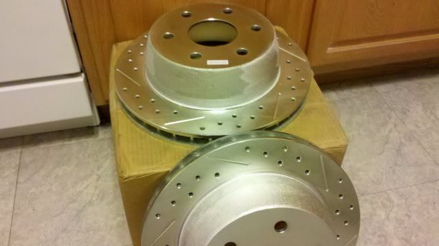

And for the rotors, I ordered some Powerstop drilled and slotted rotors. I installed these same rotors on the front brakes and I am very satisfied with them.

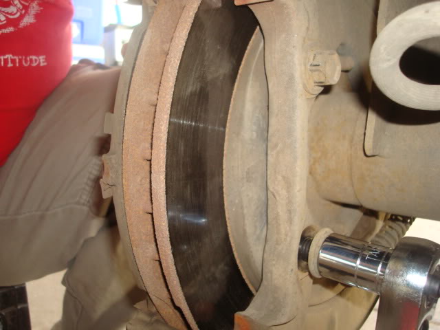

Now you have to remove the two caliper mounting bolts from the caliper slide pins with a 13mm socket (some vehicles may have differents ized bolts). The slide pins may want to spin around on you, hold them still with a 16mm wrench.
Now lift the caliper off of the caliper braket and rotor so you can remove the old pads and compress the pistons back into the caliper. I used a 5 inch "C" clamp and one of the old brake pads to compress the pistons back into the caliper. Some people simply choose to turn the bleeder screw to relieve the pressure so the piston can retract. I don't like to do that because then you have to bleed the brakes afterwards.
Now set the caliper aside. You can use a bungee cord to support it up out of the way. Do not just let it hang from the brake hose!:nono:

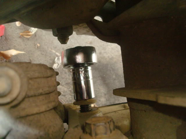

Now you need to remove the caliper braket, which is held on with two 18mm bolts, which just happened to be tight as a muthafWONker. :fume: I had to use a 1/2 inch drive 24 inch breaker bar to break them loose, then removed them with a ratchet.

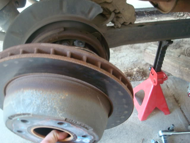

Now once you have the caliper braket off you can remove the rotor. Luckily mine came right off by just grabbing it and wiggling it side to side as I pulled it straight off of the wheels studs.
Now look at the parking brake shoes and clean them if needed or replace them if needed. (you are on your own if you need to replace those:lol:)

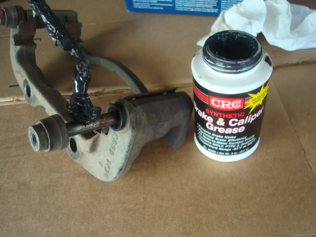

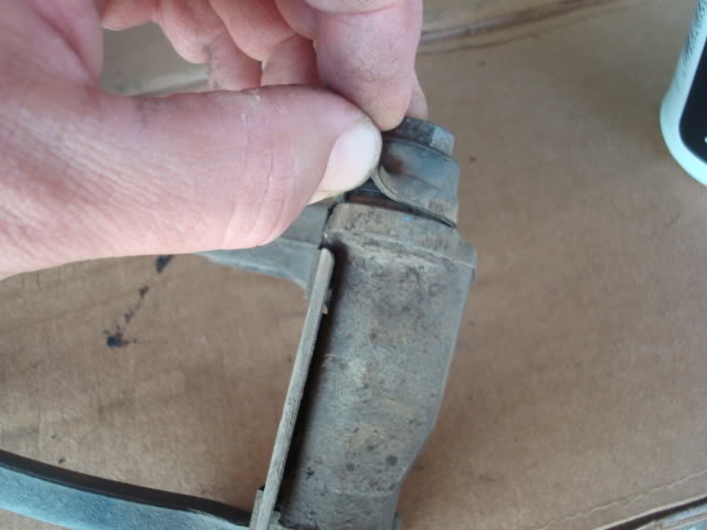

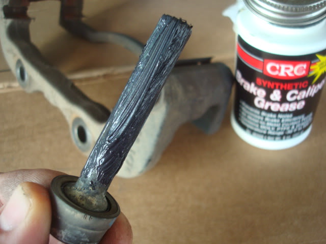

Now take your caliper braket and pop those slide pins out and clean them off and regrease them with some caliper slide grease. Just peel back the little rubber boot and the pin will slide right out.
Now get those pins popped back in and the rubber boots popped back on and wipe off any excess grease.

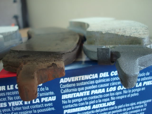

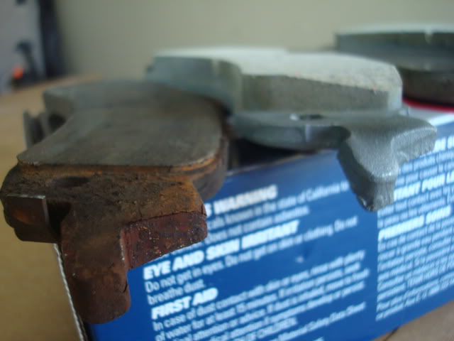

Here is some pics of my old pads next to the new ones. They were starting to get pretty thin. :lol:

One thing you didn't mention but I'm sure you did...be sure to clean the new rotors well before installation to remove the oil and residue from the new rotors. This can be done with brake parts cleaner or a bucket of Dawn dish soap...or both if you're real ****.

Yes, most rotors have an oily residue on them to prevent rust and must be cleaned before installing. However, my drilled and slotted rotors are Zinc coated and had no oily residue. I did give them one quick spray with the brake parts cleaner tho.
