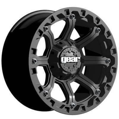

2.) What is a good rim to go with this?? I was thinking Gear Alloy 718B (Black) or KMC XD Monster (Back)

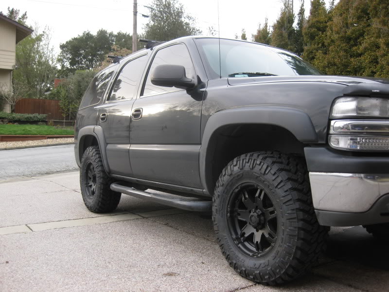

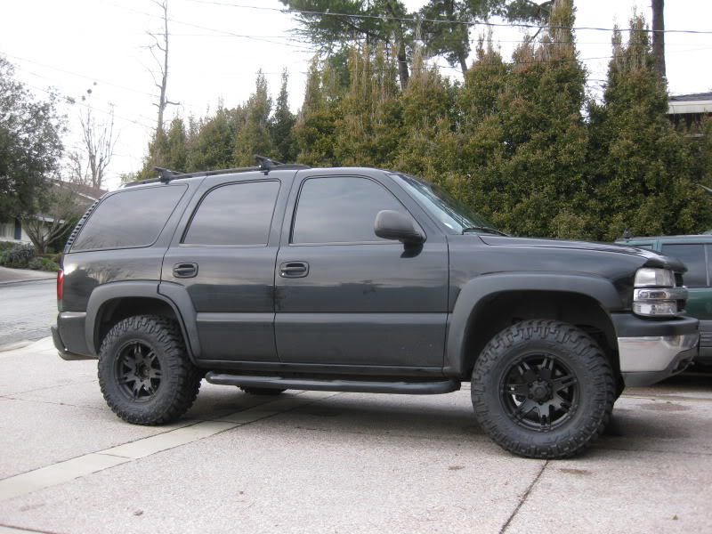

FWIW, I'm running 295/70/17 nitto trail grapplers with ultra gauntlet wheels on ford keys not cranked all the way. Have about 3/4" of bolt left. Minor rubbing when reversing in full lock. Some inner wheel well lining trimming should take care of that.
I don't go offroading that much either, but I liked the beefier/aggressive look of the trail grapplers over the terras.
