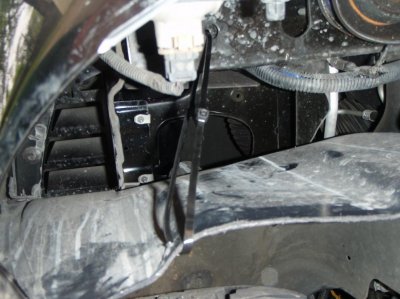

Truxxx 2.5" front leveling kit installed...still stock tires

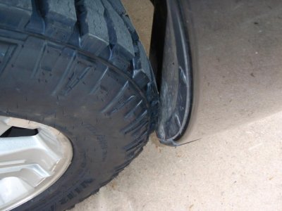

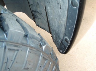

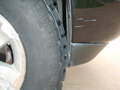

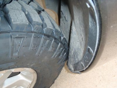

outside of tires rubbing on front inner fenders

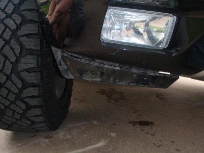

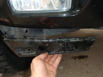

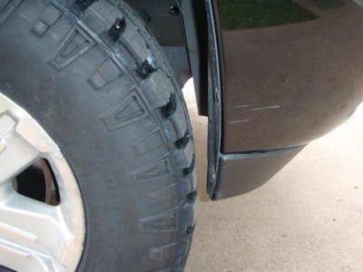

the trim job...all clear!

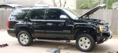

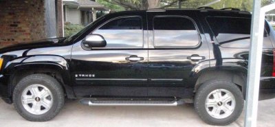

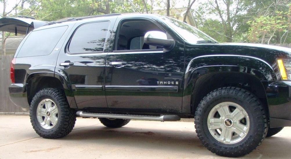

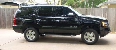

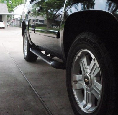

the finished product!
if anyone has questions just ask because i basically took pictures throughout the entire process

Looks good. How's the rub on the sway bar?
When i was laying underneath and watching as a buddy turned lock to lock i didnt notice it hitting the sway bar. While driving and suspension flexing I am not sure but I will keep an eye out for rub marks.
That's good. The Nitto Trail Grapplers sidewalls have blocks that rub on mine at full lock.

while pulling into a parking spot today i hear the tires rub at full lock...i looked and sure enough they were rubbing the sway bar.
ill get some pics of the rubbing once i return home but it only rubs at full lock which i can easily live with because the only time you you turn to full lock is in a parking lot at 5 mph
