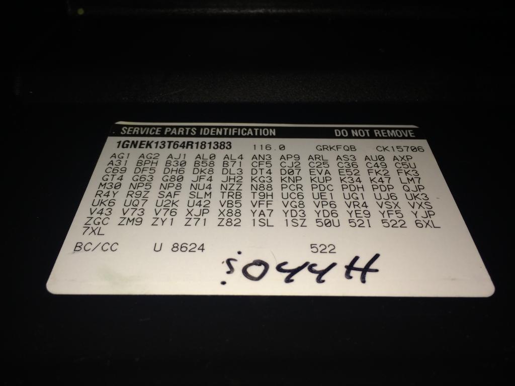

4.10 was available from the factory. Look at your RPO sheet (in your glove box) to see what gear ration you actually have:
GT4 Rear axle, 3.73 ratio
GT5 Rear axle, 4.10 ratio
GU5 Rear axle, 3.23 ratio
GU6 Rear axle, 3.42 ratio
