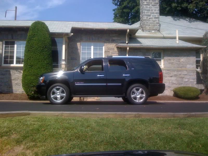

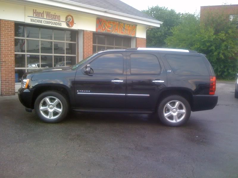

Hey all,
Finally snapped some quick & dirty iPhone pics of my Tahoe with just the rear lowered. Sorry for the quality and dirtiness. I'll take better and more-level pics when she's clean.
The rear was lowered on Belltech springs with a 1" spacer (that was trimmed and bored so that it would sit properly at the bump stop and hold the springs in place like stock). I only wanted an inch or so taken out of the rear (wanted it to ride like stock, but just not look so raked). The installer took 1-3/8" out of the rear, and I think it looks great. I'm going to see how this grows on me, and may possible take another 1/2" out.
I had Ford keys put in my '02 so that I could raise the front on it. When it was perfectly level, it actually appeared to me to sag in the rear. I want to avoid that look with this truck -- but can still probably take 1/2" out and have it closer to level without "leaning."
Check out how much more level the running boards/body side molding are now. So much better, imo.

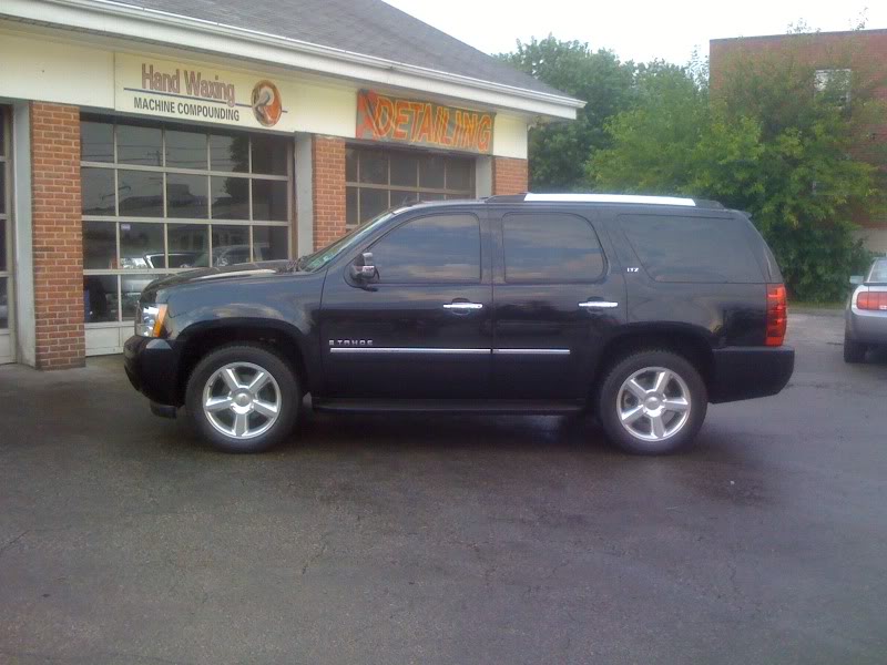

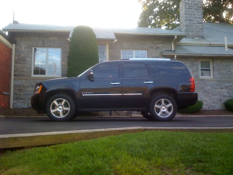

Incidentally, here's a comparison pic to show just how much gap in the rear there was. I know it's not the same angle, but you get the idea. Wow, all that gap is nasty looking!
---------- Post added at 09:58 AM ---------- Previous post was at 09:48 AM ----------
Compare this new pic to the old pic above. Much nicer, huh? Subtle, but what a difference.
