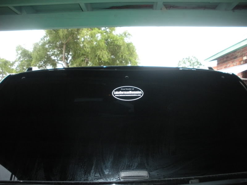

This is what your stock 3rd brake light on the 07+ Tahoe, Suburban, Denali, and Yukon's would look like..

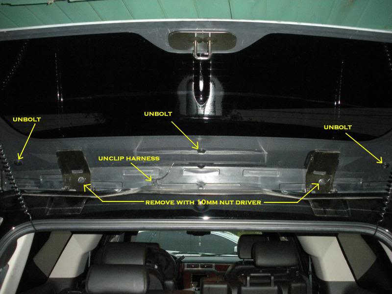

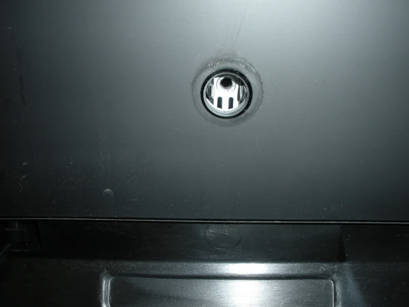

These are the tools you'll need: 10mm nut driver and a small star-bit. The two nuts and three bolts seen in this pic will be removed through this process and reinstalled with the new brake light.
Open up the glass and remove the two 10mm nuts from the hinges which attaches to the brake light housing (as seen in the pic). Also using the appropriate star-bit, remove the three bolts as pictured. They should all come out fairly easy, with very little resistance. You can also reach in and loosen the harness in the picture, but don't attempt to remove it just yet!

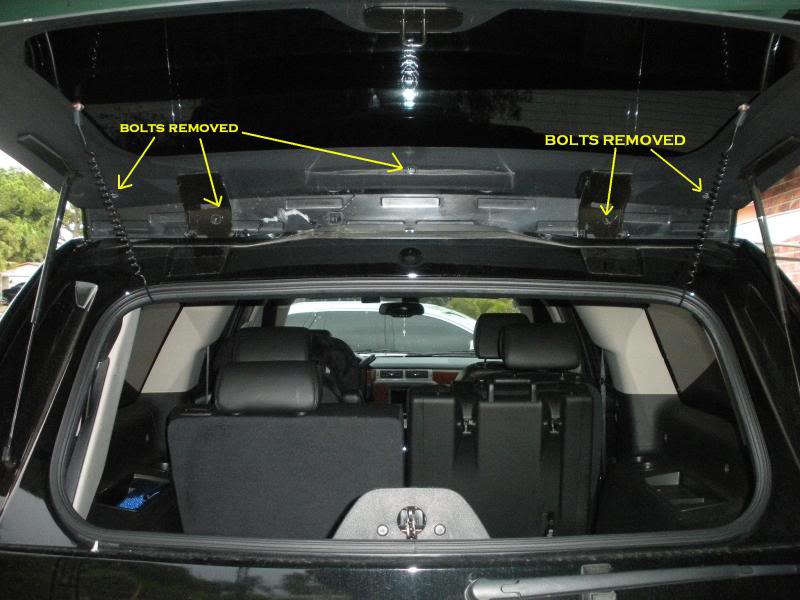

This is what it all looks like removed:

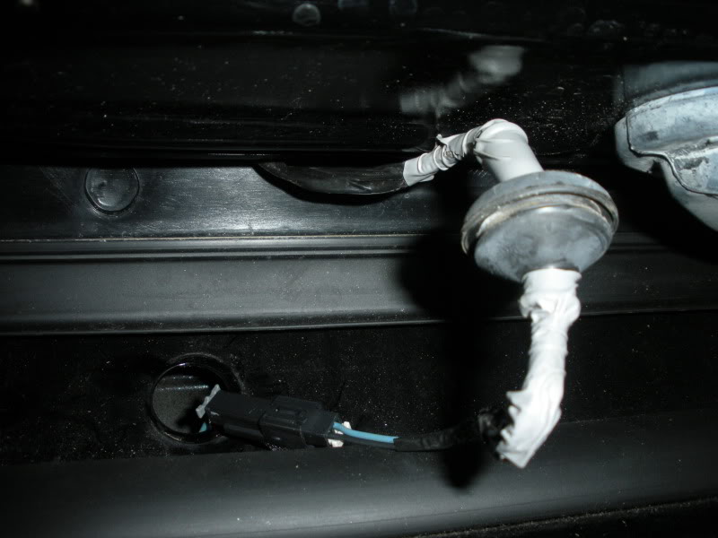

Now, open the liftgate up which will give you access to the wire harness. Remove the rubber grommet and pull a few inches of the wire out, it will come out freely without resistance. This will eventually expose the clip. Use a small screwdriver and pop the clip.
Now, close the lift gate gently, slowly lower the glass, and gently remove the old stock 3rd brake light.

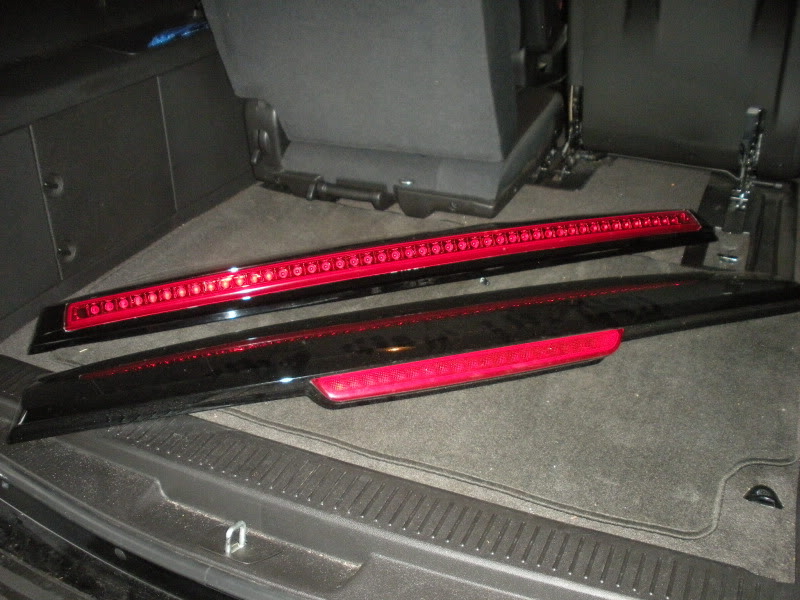

Here is the old next to the new!

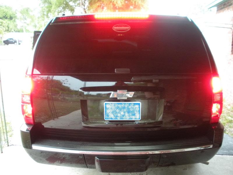

Now, do everything you just did in reverse! Here is the outcome!
