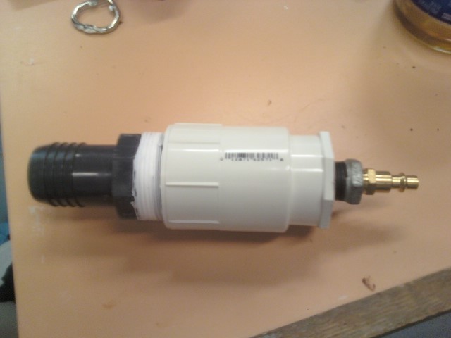

Here's what I did, for what it's worth, and it worked quite well.
Remove bottom hose at the radiator.
Remove hose from the surge tank.
Remove upper hose at radiator.
Then I took some pvc pipe fitting and found one that fit snug into that upper radiator hose and reduced it down to my air compressor fitting. Then I put about 15psi of air into that upper radiator hose. Everything in the block came gushing out the surge hose. Then I reconnected the bottom hose and the surge tank hose. Filled up the surge tank with 50/50 dexcool to the hot mark, then poured some into the upper radiator hose to fill up the block, and reconnected the upper hose.
Never had to add any more, didn't have to worry about an empty block, didn't have to purge anything, everything went just great! It took just over 12 qts (3 gal) of 50/50 which is the capacity of my system.
P.S. The part I didn't like about just taking off the lower hose is that you don't empty the block out because the thermostat is closed. You just drain the radiator which doesn't hold that much anyway.

Here is what I used to blow out the fluid in the block from the upper radiator hose.

Cool PVC device... I'll have to put one together and flush it that way.
