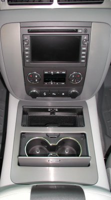

I ordered part 25807746 (plate that goes around the Radio/AC/Navigation spot on the front center console) on 07-08-11 that I think will work in my 2010 Tahoe LTZ, and should also work in a 2011 Tahoe. I'll post an update on this part when I receive it.
Confirmation that part 25807746 (plate that goes around the Radio/AC/Navigation spot on the front center console) is the correct replacement part for those that want to go with the Z71 look over the fake wood look. Installed this evening. :)

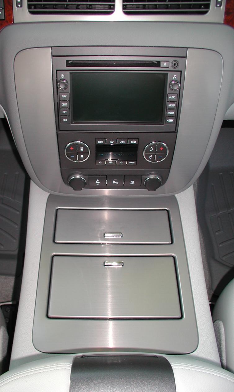

I'm going to add a ninth part to this project for those that have the front center console where the unit with the two compartment (one for storage and one for holding two drinks) lids has the fake wood trim covering. The Z71 trim part number may be 20951471 (very close to the fake wood trim part number in my 2010 Tahoe LTZ, which is part 20951473). I ordered part 20951471 on 07-10-11, and I'll post an update on this part when I receive it, so don't anyone go out and order one right now! :think:
Confirmation that part 20951471 is the correct replacement part for those that want to go with the Z71 look over the fake wood look. Installed this evening. :)
