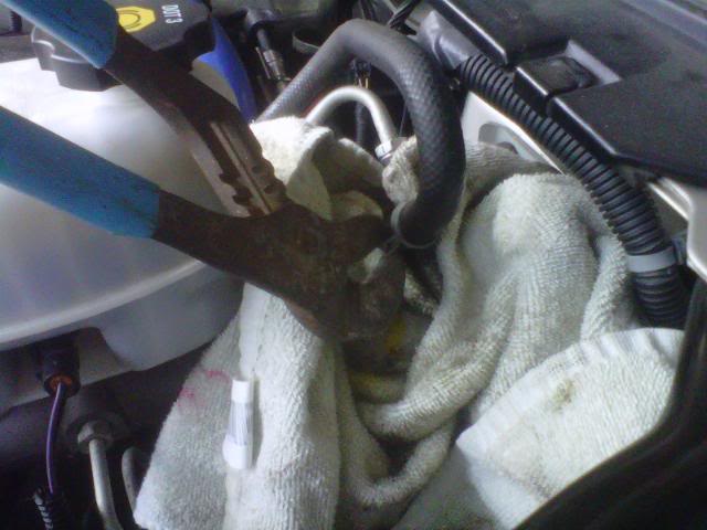

To get started Place a rag under the power steering fluid return line at the top of the hydroboost unit. This rag should cover the hydroboost unit, it will catch the power steering fluid you lose while removing the return line.
![IMG-20110802-00359.jpg IMG-20110802-00359.jpg](https://www.tahoeyukonforum.com/data/attachments/114/114060-26af3d945b54372c8e7debaafca982f5.jpg)
Then use either channel lock, needle nose or clamp pliers to squeeze the clamp and twist the return line to losen it for removal. The line can be super tight, if not stuck in place if it has been a while since the last flush, so be very careful when pulling it off to avoid hurting your hand against the cowl.
