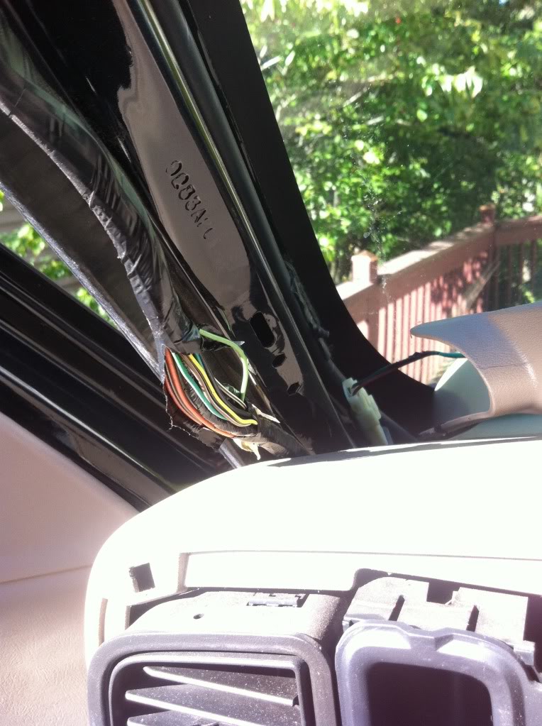

As for the install, like i said it's been chronicled a few times on here but there were a couple of questions i had even following those tutorials. One was power to the monitor. For me i didn't want to run the power cable all the way to the back of the truck to power it off of the same source as the camera, just so i didn't have to run so much cable. So i went looking around up in the front of the cab and found this little green guy in the a-pillar, that i found out with a tester, only powered up with the truck in reverse SCORE!
It's the wire that is sticking out to the right. There were quite a few green wires in there so note the color of this one if you do this. Or if you have a 12 volt tester you can fish around in there and find it with that.

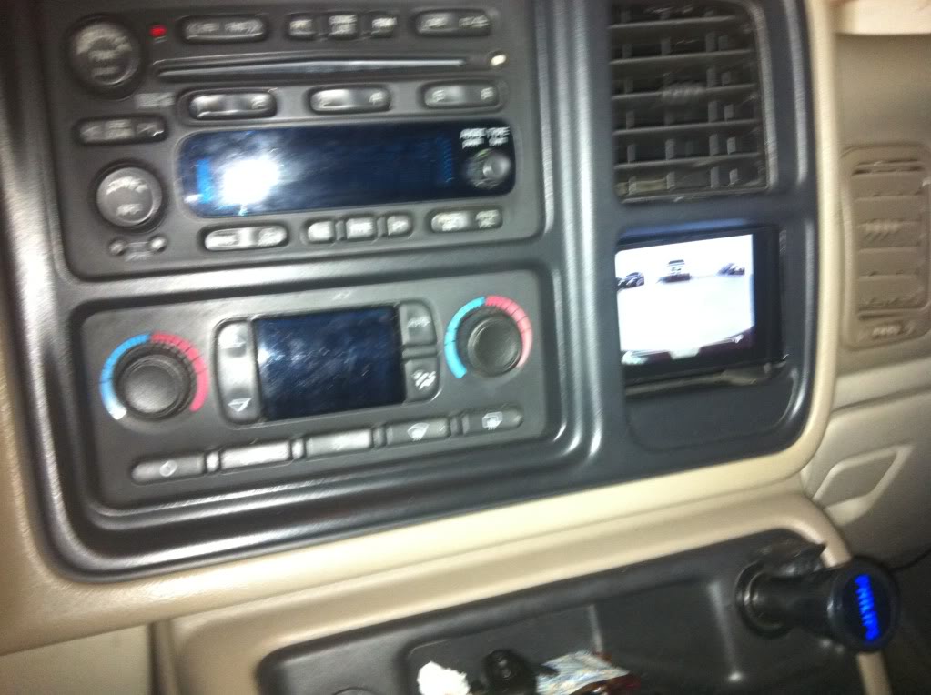

After i got power to the screen i started deciding how to mount it. This screen wasn't ideal but it works ok. You can come up with your own mounting ideas but i'll show you what i did. When i pulled out all the guts of that cubby i decided to hack off the "legs" that attached it to the dash and just use them on the screen to mount it in there. So i hacked them off measuring the thickness of the screen to get them the right length and attached them to the back of the monitor. First with just double stick tape to test it.
When i put it in the truck it looked pretty good but i wanted it angled a tad towards me so i could see it better so i took a little more off the left one to give it an angle.
Then tried it again. When i was satisfied with the placement. I scarred the screen where the "legs" would be and used some plastic glue to attach them.

So as i said before the only thing i would change is the screen. It works, and i'll probably leave it be but there is a couple things about it it didn't like. First i didn't notice the resolution was lower than most of the screens until after i already bid on it (hence the $10 price i got it for i suppose) and second is the extended sides on it. If you look at the picture the area to the left and right of the screen posed a bit of a problem when trying to center it in the hole in the dash. It's a tad off center and it drives me nuts (i'm a bit of a perfectionist i guess).

if u go back to whatever thread i posted in several months ago on almost the same install, my monitor is mounted a little differently but simliar. on mine, i sat the cubby hole face down on the work bench, and sat the monitor down flat next to it and marked how thick it was by just marking the sides of the cubby to knwo where to cut it back...and i cut it back that same thickness and jb welded the monitor to it. its more sturdy IMO than the route u took, since it uses the entire cubby hole bonded to the monitor instead of just the clips...probally not much need though, just what i did.
the power wire in the A pillar is what most of us have used i believe... the only thing is your monitor will come on when you unlock if u have the peremiter lighting set to on...easy way around that is to add a relay with the green wire being the trigger and run the power for the relay off an ign source like i did.
