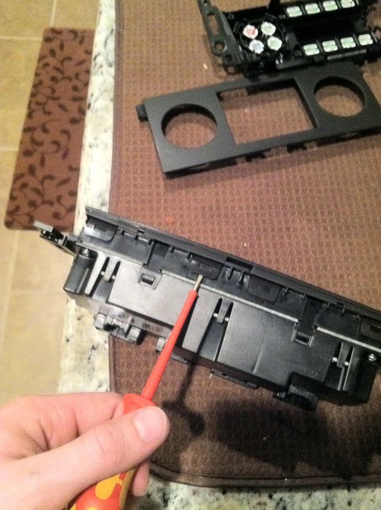

Use a flat head screwdriver and pop off all 8 tabs of the face plate, 4 on each side
Next seperate the back of the module from the buttons/faceplate using the flat head to push the tabs down and pull apart

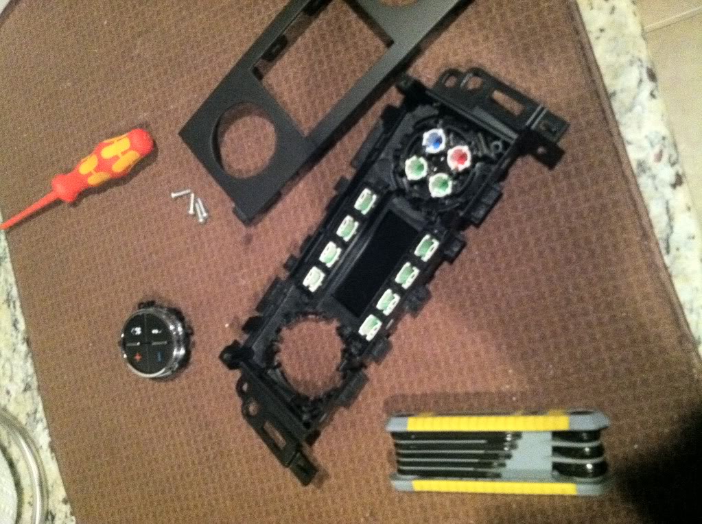

then it will look something like this
From here on out, you can pick and choose what you want to swap out, you can see i popped out one set of the buttons but I ended up swapping all the buttons...
