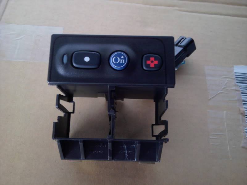

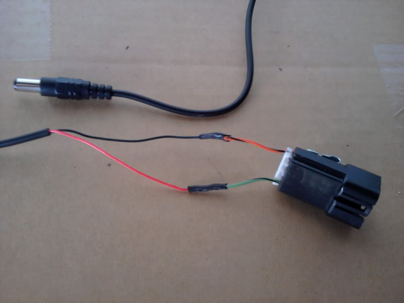

I started with a 2000 Yukon SLT w/ all options for the year including OnStar. I thought I would be slick and modify the OnStar harness to get my power and ground for the monitor. I figured that since the camera would only be on w/ the reverse lights, I could deal with the blank monitor.
Connector all de-pinned and soldered:

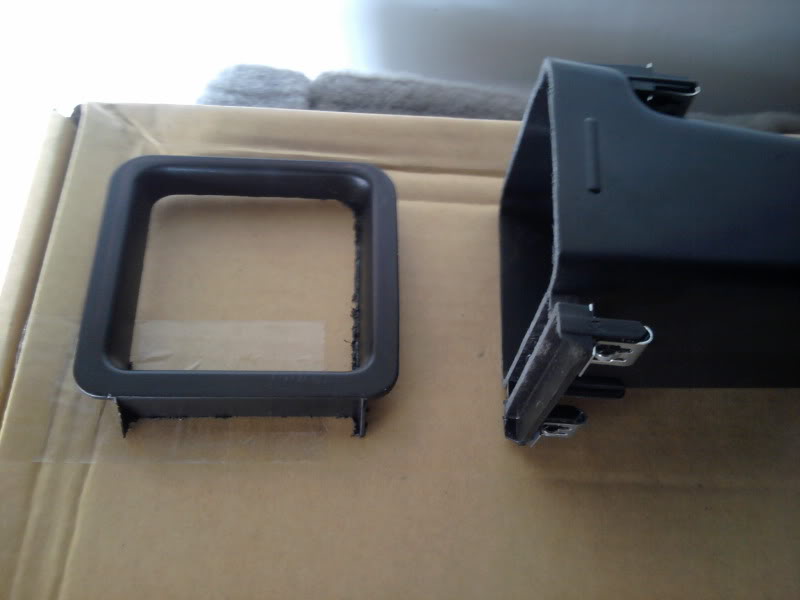

The next step was taking some measurements and modifying GM PN 15207926 from this:
To this:
After that I broke out the JB Weld and secured my monitor to the compartment:
Got it fitting well:

That's when I found out my snazzy OnStar harness didn't feed power to the monitor. D'Oh!!

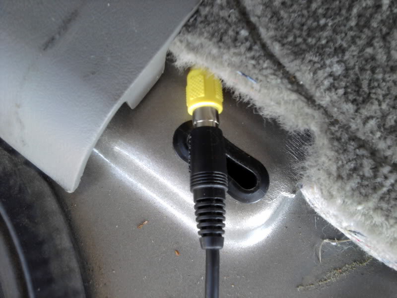

So I ran the power and ground for the monitor down the same way I ran the video cable:
I needed a 6ft extension, but I was able to sneak the video cable through the weatherstripping and I found a hole below the trim piece that ran out the bottom of the truck for my monitor's power and ground:
