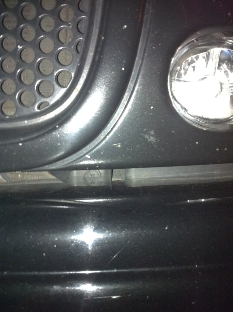

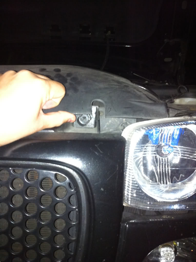

If I'm not mistaken, the part of the grille that goes around the lights has a clip in either side that snaps into the side. Also there are a few bolts on top at the front when you pop the hood.
Location of clips:
Bolts are under this cover:

I am not sure of your year... This would be for 00-06... Don't know if Denali would be different.

There is a clip on each side of the grille assembly by the headlight as shown in the pictures. There are also 2 screws on the bottom of the grille-one on each side--push your bumper cover down just a tad and you can see them or use a flashlight. There are also upper mounting points as well underneath that radiator cover. If your insert itself is loose....don't know what to tell ya as I believe it is held in with multiple tabs around the grille shell...

It's held in by six mounting points as Jason said. 4 screw type tabs around the "center" grille and two on the far end by the turns/DRLs that clip into the frame. All you need is a Phillips screwdriver

Yeah, thanks....those pics tell the story. I'll check it out more tomorrow. Sounds more like it's rattling near the bottom than the top.
