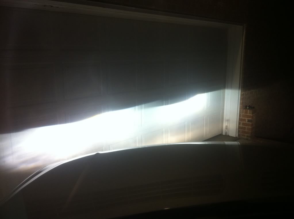

That is going to ruin the beam pattern. The "light restrictor" was made that way for a reason. Removing it is just going to blind everyone! I would suggest something better than this...

Also, like kses said, removing that restrictor pretty much turns it into a halogen reflector with a pretty piece of glass on the front. Seems like a waste to buy the housing when you could have just put it in the OEM housing and added some Halos yourself with the same effect. But, to each his own.
Haha no doubt there. Suggest all you want, I did. It worked. Feel free to revise and repost. "Ruin", you mean take away half the output. I personally think its hilarious to watch what some people do when I'm behind them with my lights on. This one guy was obnoxiously making shadow puppets in his mirror, taking a piece of 8 1/2"x11" sheet of paper and folding it over his mirror. Followed him all the way to my (and his apparently) son's daycare and when I walked in with him he said "You know your lights are obscenely bright?" and I said "Obscene is a gross exaduration, they help" to which he replied "Well, they dont help me". I understand where he's coming from, but I'd rather have projectors with HIDs in my rearview than ones with standard "ridged" plastic diffusion, not to sound arrogant, but its annoying and they look tacky. I think the output from projectors with light restrictors looks tacky too...
Ruin, no. Give me way more of my lumens. Yes. Annoy other drivers? Yes. Help emmensely in blinding snowdrifts? F*ck yes.
HIDGuy, I wrote up a review in their thread area. Kit was good and all, some parts missing. But one thing I have noticed is that there is like a yellowish spot in the middle left of my passenger side bulb output. I think what this might have to do with is the restrictors not being ground to the same size, so whereas my drivers side is fine, the passenger side is allowing a different portion of the light spectrum to be exposed, illuminated from the bulb, causing a different purportion of the rainbow to shine through.

output pics?
Shoot, good call. I will post those tonight as well, once I can take pics when its dark
EDIT* Come to think about it, it might not be tonight because it is still finals week and I have a BUNCH of shit to do before Friday. Pics of how they look on as well as the output will be posted by the end of this weekend for sure.
