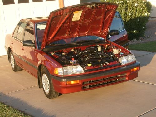

For starters, lets look at what you'll probably end up seeing when you lift the hood if you've never had your engine detailed...in this case, it hadn't been detailed in a couple decades
This is a 1988 Honda Civic engine. The paint itself had more swirls than you can imagine and quite frankly matched how bad the engine looked lol. So as I'm sure you can figure, if the paint wasn't even cared for, the engine wasn't even thought of until we talked to the owner.

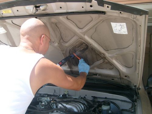

I would recommend cleaning the underside of the hood next...so that way if you end up having any dirt etc. rinse down..its only going to run onto a small area thats already dirty, not onto a clean area that you'll have to RE-clean.

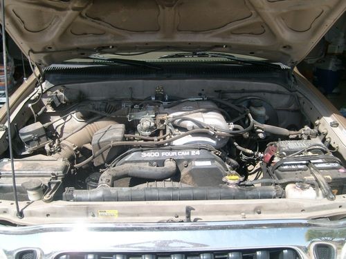

(Toyota Tacoma Engine, looked like someone refilled the oil but forgot to put the cap back on when they finished...oil bomb!)

Let the cleaner set for a few seconds, then start working with your brushes to agitate the dirt. If its light dirt, not a lot of pressure is needed, you're just loosening it up. Now if its caked on grease like what is seen on the hood in the above picture...you will need to work it.
In the case of the hood, you're dealing with PAINT...and you don't want to scrub the paint too hard because you can scratch it OR even remove it. So go slowly. Same goes for any finished pieces with chrome or paint...don't scrub it like you're scrubbing your tub...use force but don't kill it...you don't want to mar anything. Now with those rubber hoses and such, they're pretty tough so you can lay into them a little more if needed. Just make sure no matter what you're cleaning, try not to let the cleaner COMPLETELY dry...if its drying faster than you can work...spray a smaller section next time or just rinse as you go.
In the case of the hood above, i used a steamer to loosen the grease (pressure washer would have blasted it off faster but a lot of water would have run uncontrolled onto the engine) and a soft tooth brush to scrub it.
If a steamer is unavailable, don't fret. Just use a spray bottle with your cleaner in it. Just be sure to clean your brush often in a bucket of water, or else you'll just end up smearing the grease all over.

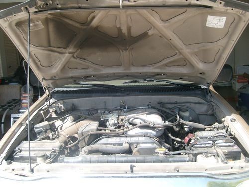

If you look closely, you can see the left half of the hood has already been cleaned (nice and gold)...but the whole right half (the part im working on) is quite black.
If you're dealing with just dirt, after using your brushes on the areas, go ahead and rinse the area you cleaned. Try not to get too much water on the area you haven't yet cleaned. The reason for this is, if you get water onto an area you havent used your cleaner on yet, the water is going to dilute your cleaner after you spray it and thus weakening its cleaning ability.

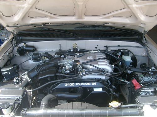

When you're finished it should look like this :
