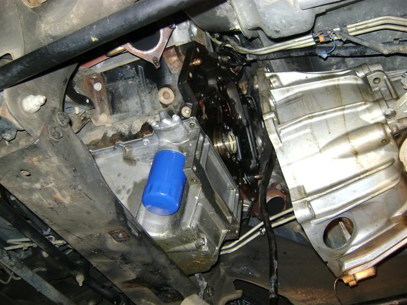

I've been screwing around chasing the infamous engine oil leak on my 02 and after doing the oil pan gasket, intake manifold set (was hoping it was one of the sensors on the rear top of the intake) and as a hail mary- the valve covers, I finally bit the bullet yesterday and did the rear main.
A buddy let me use a lift at his shop and I got it done yesterday. He said it was a four hour job which I don't believe, even for a "professional mechanic." Took me 12. A lot of time was wasted trying to find tools (as I was working at his place, not mine so I couldn't find anything). He didn't give me a lot of help, mostly laughed at my phoentic cursing and then went home and took a nap. The main was definitely wet and I changed both the rear cover gasket and the main seal (the kit was less than $25 at Napa). I also serviced the tranny (dumped the fluid, changed the filter, removed and replaced the tail extension o-ring.
The worst part of the job, believe it or not, was trying the get the tranny dipstick tube back in place (f*cked with it for probably an hour), and trying the figure out the damn circlips on the tranny cooler lines (I dropped one, it disappeared on the shop floor and I spent 40 mins looking for it).
I had a 20 mile drive back to the house. No leaks yet.... Tranny felt good. My fluid was definitely worn/brown but the pan and the filter element looked good (looked original too) after 200K miles.
Fingers are crossed that the SOB leak is finally fixed....

I'm sure if you were to do the job again you could do it in Half the time. Just be thankful you had access to a lift that would of been a nightmare on your back and i'm sure someone out there has done it too. Thanks for the info my girlfriend has a 2000 and I suspect the seal but there is also oil on the oil pan bolts so I can relate to your frustration after doing a pan gasket and still no fix. I Wont do a Main myself and I give you lots of credit for even attempting it. I hate leaks too, I bet your's was leaking like her's where you have lots of drips and the bottom of the bell housing is all wet and the exhaust has oil from blowing back as you drive. Thanks so much for writing this thread it was just the info I needed to figure out what I'm going to do and Not Do. J T.
---------- Post added at 03:26 PM ---------- Previous post was at 03:03 PM ----------
As you can see John those Seals are only good for about 10 years, and 200,000 mi. I guess that is pretty good if you figure how many hours of operating time that is. I feel your pain, I did a water pump once and about a month later had a coolent leak that was hard to see where it was coming from so I did the intake and all along it was the water pump gasket that I know I did right so I used two gaskets the second time and it took care the leak. Thanks for including the picture it shows everything you need to remove.

I could do it quicker now I'm sure- I took a lot of care during disassembly and reassembly- everything got cleaned before it went back on and I put everything back EXACTLY like it came off. No broken clips or harnesses, nothing bent. Just like it was supposed to be. A production shop would have just hauled ass to get it done in book time and not care what they screwed up in the process.
I've got over 1,000 miles on the repair now (drove the truck to northern MI) and it is bone dry underneath so I can say with confidence the leak is no more. Too bad my freaking windshield washer froze and I've not been able to clean my windshield in days. Damn its cold up here! Going back south tomorrow! It should thaw out around Detroit I'm guessing....
