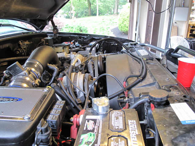

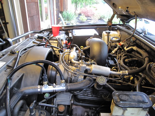

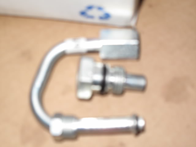

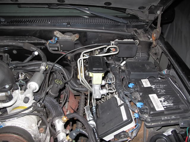

Hydroboost Conversion w/PS Cooler - this is all new AC Delco components (base vehicle k2500)..PS cooler from '97 K3500
This was used to delete variable steering from PS pump - GM #19168825

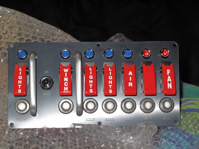

12Voltguy Custom Panel
Mark VIII Efan - custom wiring setup to engage both speeds automatically
Volant CAI:

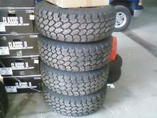

ProComp Extreme AT 285/70R17

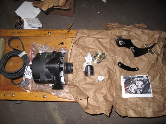

Iraggi 220 alt - 180amp @ Idle!!!

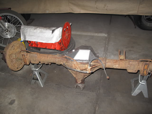

14bsf 6 lug rear w/Blue Torch diff cover - COMPLETELY rebuilt w/Timken Bearings & Tru Trac

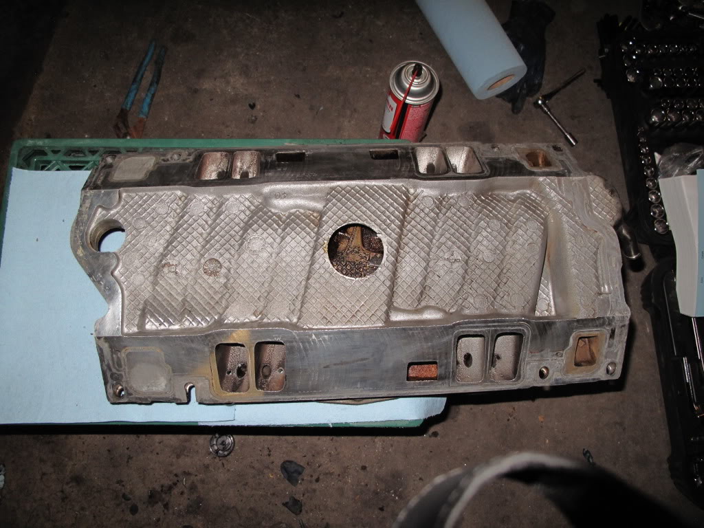

Updated Fuel Injector Spider
Timken Hub Bearing Replacement

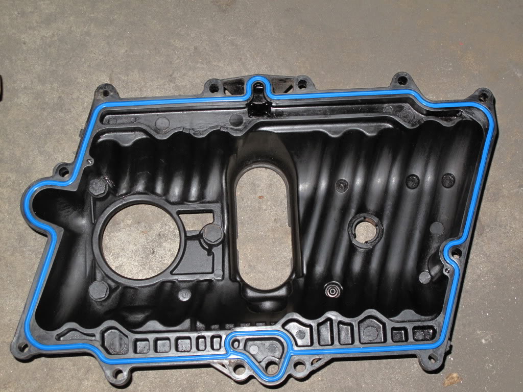

Manifold Gasket Replacement (clean manifold!)
Plenum Gasket

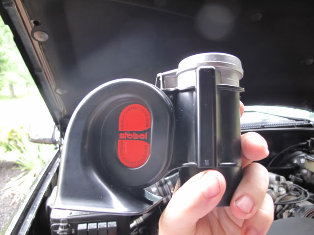

Electric Air Horn - 300hz

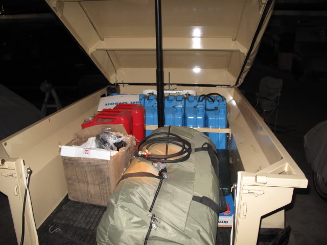

Custom Trailer:
Interior

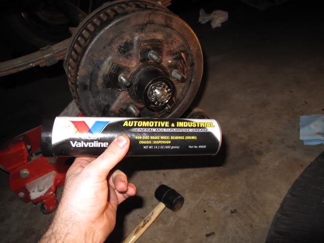

Trailer Bearing Lube
As you can imagine, I've also swapped out every fluid (trans, front diff, rear diff, transfer case, oil, coolant)

nicely done. what did the Hydroboost swap cost? part numbers? and scale of 1 to 10 how well does that thing stop now?! haha

A ridiculous amount of $$ and it stops much better now. I don't have the part #'s on me, but i essentially went to rockauto, threw in '99 K2500 and bought:
x3 power steering lines, power steering pump, hydro unit, master cylinder, gm bypass, hydro pedal, 3/4t calipers, 3/4t pads (need to be shaved for 1/2t discs). None of the parts on your truck will work correctly with the hydro unit...some ppl make it work, but you will develop problems down the road (i.e. t-fitting off stock PS pump) if you don't swap everything.
I also HIGHLY recommend a PS steering cooler. I did a bit of research on the diesel forums and they were somewhat regularly exceeding the recommended temps on their PS fluid when they didn't have a cooler. For OBS, I believe only the k3500 had coolers...but they mount in the OEM location. OEM is $100+, but you can find a rail cooler for $30 from summit (just measure everything before you buy)
Sometime this week i'll do some actual stopping distance tests and release all the findings from vacuum to hydro

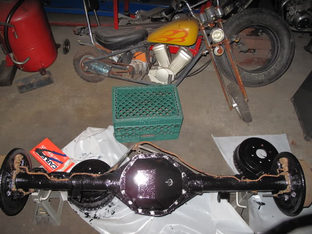

Finished prepping and POR'ing the 14bsf - now I'm waiting for my Wagner severe duty shoes and I'll rebuild the drums and bend up some new brake lines.
before
after

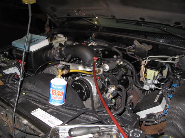

Replaced the Compressor, drier and orifice tube...
After installing the new system, evacuating and filling with refrigerant...the high pressure relief valve went south...and I had to do it all over again!

The trailer weighs around 2500 when fully loaded.
