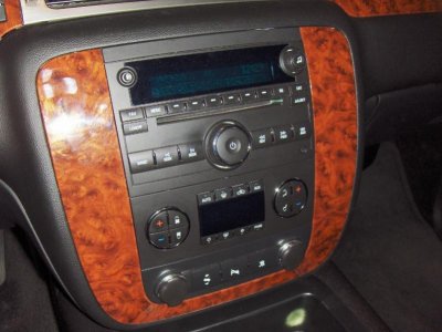

I already have an amp pushing 2 12" Rockford Fosgates, I am adding a 4 channel amp and replacing my front and rear speakers. I have the PAC unit in and everything still works fine. I will post some pictures here in a bit.

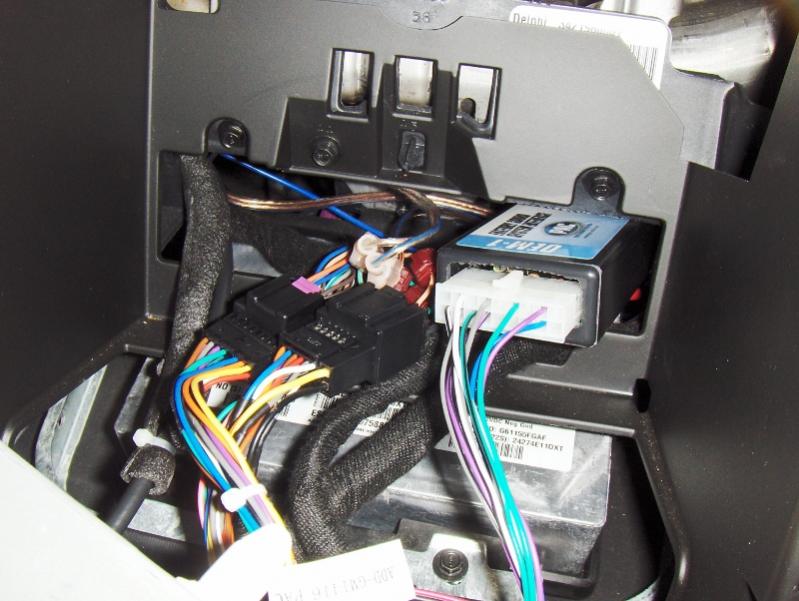

The entire process took about an hour, but that's me taking my time and checking everything still works before I put it all together. The back of the unit has 2 plugs that look a little different so there wasn't any issues on which A, B, or C cables to use like the instructions show. The RCA cables are in easy reach and I am just waiting on my front components to get here. The PAC unit was about $35 from Amazon.
