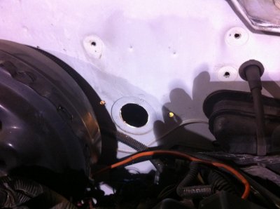

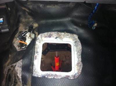

Alright guys I am ready to do my Nv4500 Swap. I have a complete 96 NV4500 with the matching transfer case and yokes to adapt to my drive lines. I have a clutch pedal assembly ready to be bolted in as well. The rest of the parts will be sourced new from rock auto.

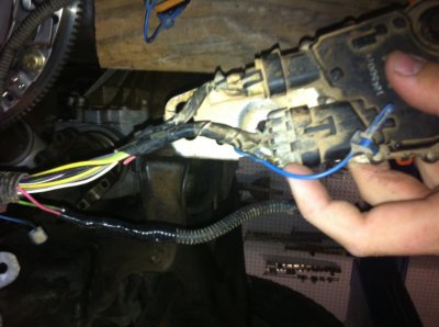

I know that if I remove the gear selector from side of my automatic transmission and leave it plugged in (in the park position) then I will be able to operate the vehicle. My problem is that the ECM will throw codes for the automatic trans. I can't pass smog inspection if the check engine light is on or has been disabled.
I have talked to a couple people who have done the swap on 96+ gm vehicles but I haven't found anyone who lives in a smog inspection area.
My Tahoe came stock with the manual shift transfer case so I am not worried about that.
My question is: can the codes thrown for the automatic trans be tuned out?
I believe that it is going to throw a transmission slip code, but what other codes will it throw?
Sunlitcomet, can you shed any light on my situation?
Thank you,
Kyle

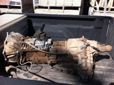

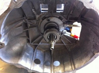

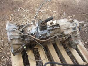

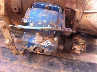

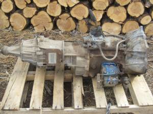

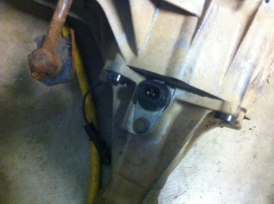

I picked up the transmission over the weekend and the pedal assembly is being pulled as we speak. The transfer case that came with the transmission is a Borg Warner 4401. After a quick search it appears that the front yoke on the transfer case uses the same U joint as the 241. Hopefully I will be able to get the pedals in this week so the manual can go in over the next couple weekends. Here are a couple pics of the trans and the PTO. I will probably remove the PTO and replace it with a stock cover.

hey im looking into doing this aswell does the manual have to be from a 96+ if in=m putting it in a 96?
SunlitComet
OBS Jedi-Do Good
Sep 30, 2010
16,206
188
unknown at this time.
not really if it is the same length has same bell housing pattern year should not matter. Although 98-newer may have a difference in wiring for nuetral/backup switch.

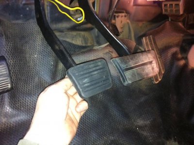

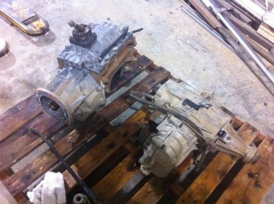

Well I got the NV4500 all cleaned up and it looks like a winner! Super clean inside; no brass in the oil or chipped teeth. The 5th gear nut was nice and snug as well. I was going to rebuild the unit before I installed it however this one seems to be good enough that I will wait. A full rebuild will be in order when the ZZ4 crate engine goes in down the road. I Removed the top cover to inspect all the syncros and gears, removed the PTO, picked up a second PTO cover/ gaskets and rinsed out the case.
Also, I got the pedal cleaned up and painted.
From Napa I picked up a Clutch Safety Switch and Master Cylinder so that I can get the pedal all mounted up before I pull the Automatic out.
