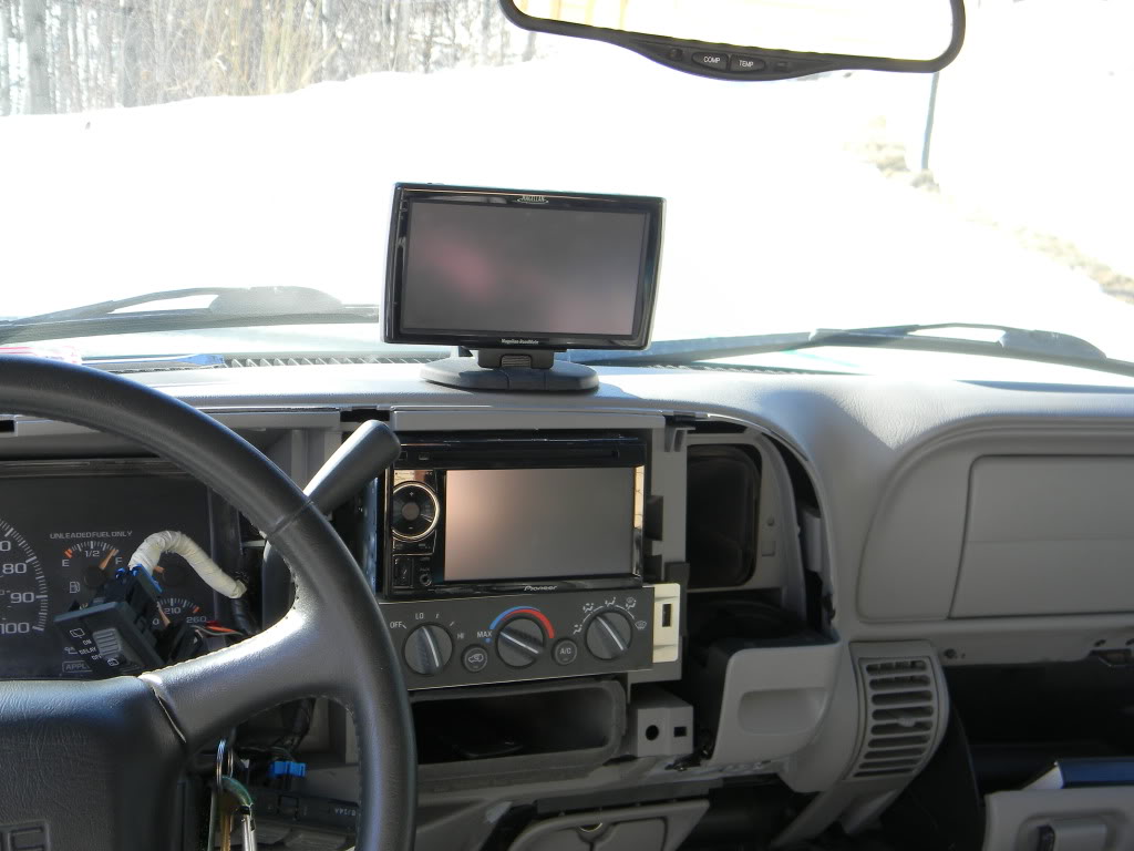

ditching the storage tray.. dropping AC controls down and integrating 2nd display into the dash so its not sitting on top....
I use the cubby too much to lose it. And the GPS on top of the dash will go away one day, when I spring for the GPS in the headunit. The Pioneer dubdin unit I got is GPS ready, but the unit to make it work is expensive, and I have a GPS already so...

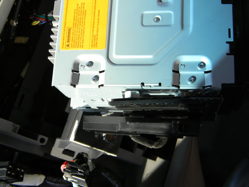

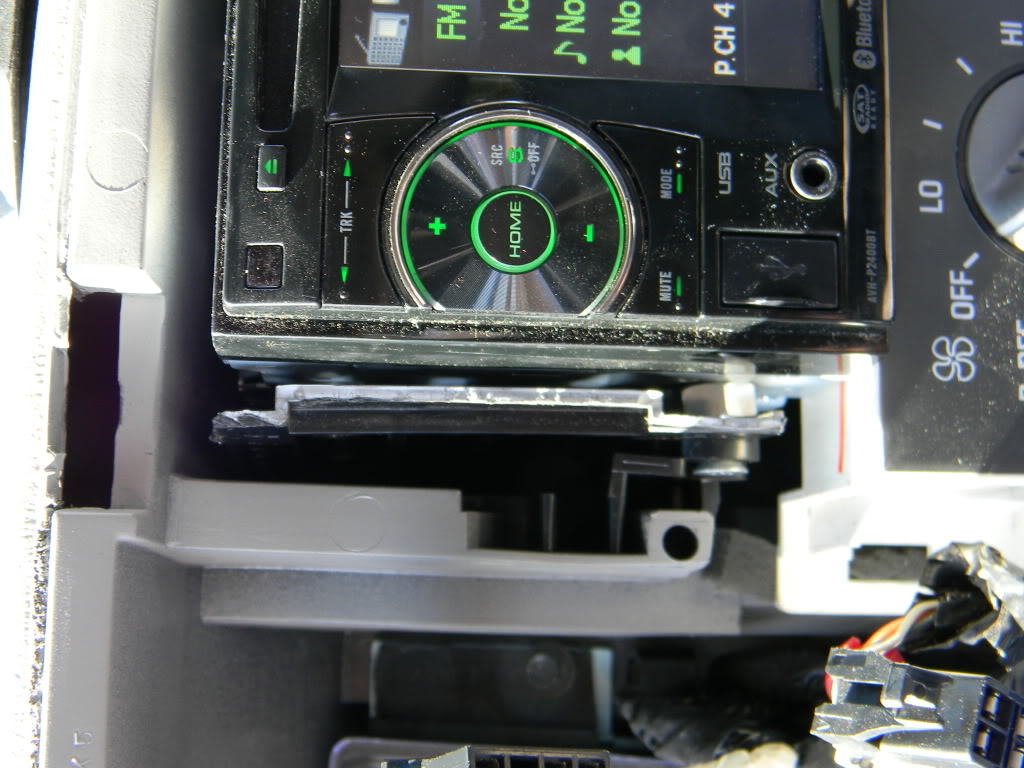

Got the headunit mounted up, hacked an install kit from wal-mart to make it work with the factory slides/clips using some nuts and longer screws.
It sits a little lower than I intended, (the base of the radio sits on the A/C controls) but overall I'm happy with it.
Got the dash cut to fit around it, now I just need to get some putty and cut up the junkyard dash I used as a mockup to fill in the gaps. Then paint.
