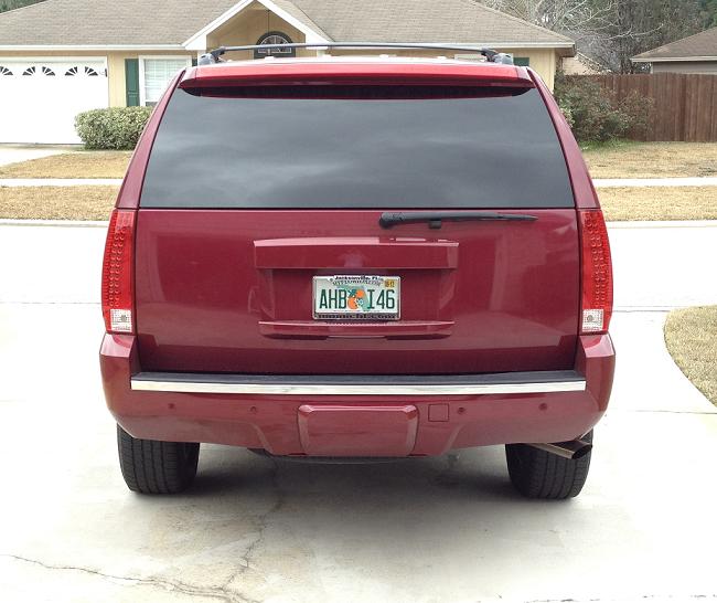

This was installed when I bought the truck. Looks fine for now...
Couldn't tell you anything about it though. I can measure it later tonight if you want.
No need to measure Nathan, thnaks very much. Just need to see what things looks like and this is definitely a start.

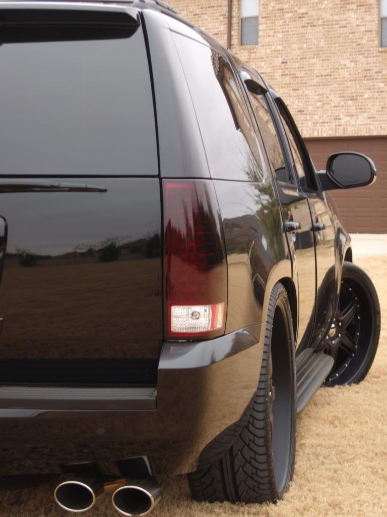

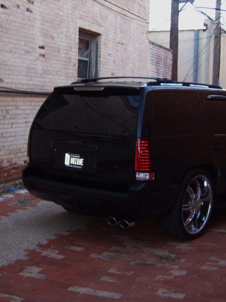

Two different Magnaflow tips I have had.
Thanks very much Neo.
I like the DUAL one, HOW do you attach that back there to the original OEM pipe which is angled downwards? Does the Magnaflow tip bend upwards to make it kind of level out? Or do you get rid of the complete back (not sure what one should call it, is that the muffler bucket there on the NNBS truck?) and just attach the tip with a new straight pipe there?

The resonator is removed and the tip or tip/extension is added.

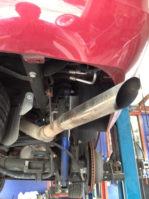

The single tip just required cutting out the resonator and adding some extra pipe (about 8") and a tip.
The dual tip required cutting all the pipe from the rear exhaust hangar back. Then replacing it with about 6" of pipe that goes straight back (not angled to corner like the stock exhaust) and then the dual walled tip.
The first tip cost $50 if I remember right. The second cost $160.
