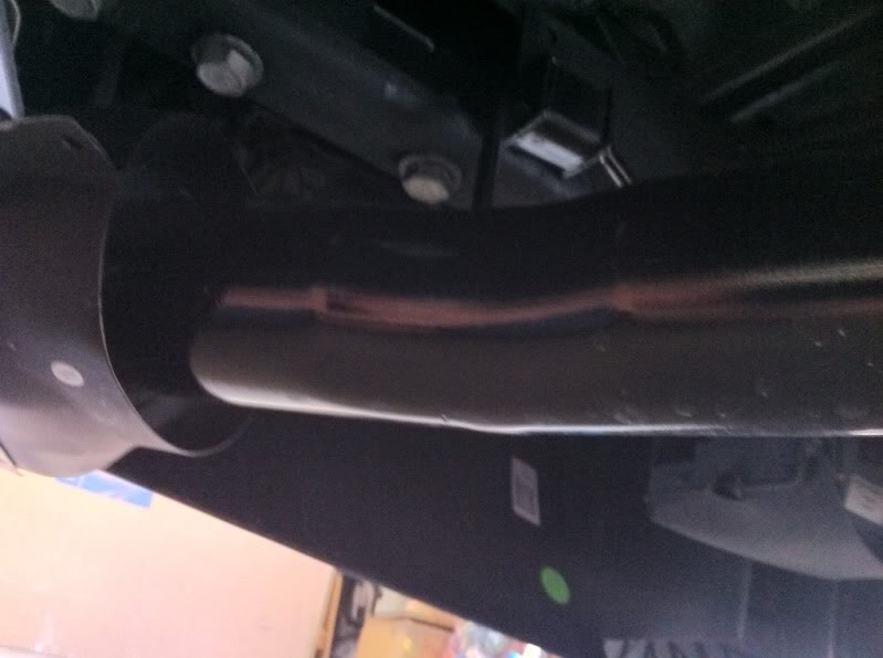

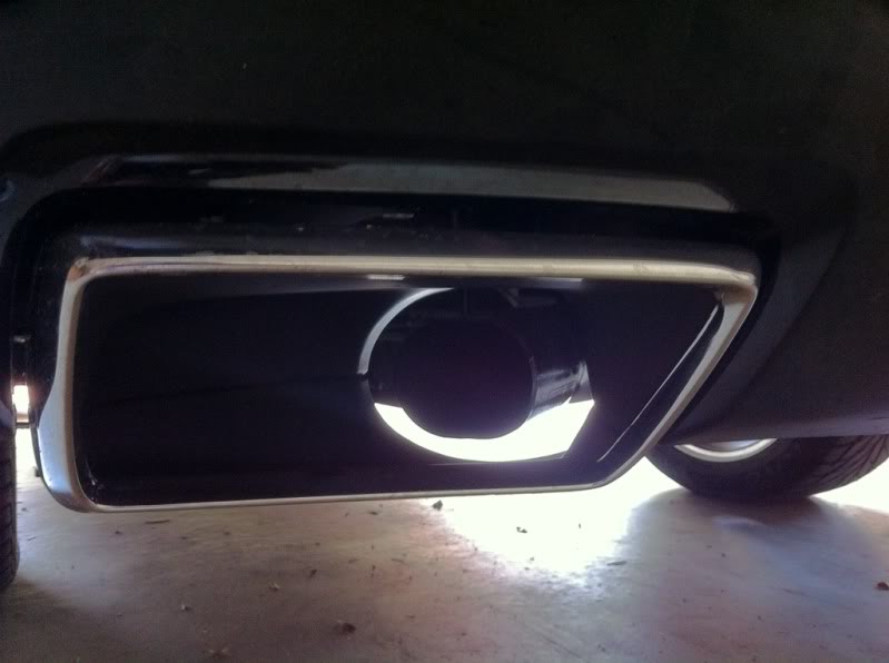

Some folks were asking to see... so here ya go.

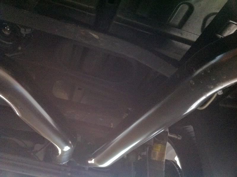

Wifey's Burban with the new '12 Premium Escalade Bumper. Corsa Sport 3" exhaust into a 3" Y-pipe and out to two dual 3" pipes.
If you need any other specific pics, let me know. :Handshake:
P/N for 2012 Premium Bumper Conversion...
22756668 - Hitch Cover
22756941 - Exhaust Sleeve
22756942 - Exhaust Sleeve
22756666 - Non-ESV Bumper Cover
22756664 - ESV Bumper Cover
(There is also a bracket that holds the hitch cover on, I don't have that PN on my desk at the moment)

Still running spare? Any pics of the exhaust routed? Keep going back and forth on getting the bumper.

Nice!! Any vids? Also, I'd like to see picsof the pipes from the axle back.
no, you cannot run the spare SAFELY with this setup. Pics posted above.
(the bold and underlined is not directed towards you, just directed towards those who are going to insist its possible)
Burban is going on ebay tomorrow (as long as I can get her out for photos). I was going to do a video of the entire vehicle. What video are u looking for?
