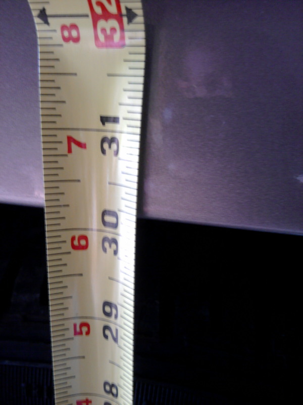

Been driving the truck with these lovely looking front fender measurements:

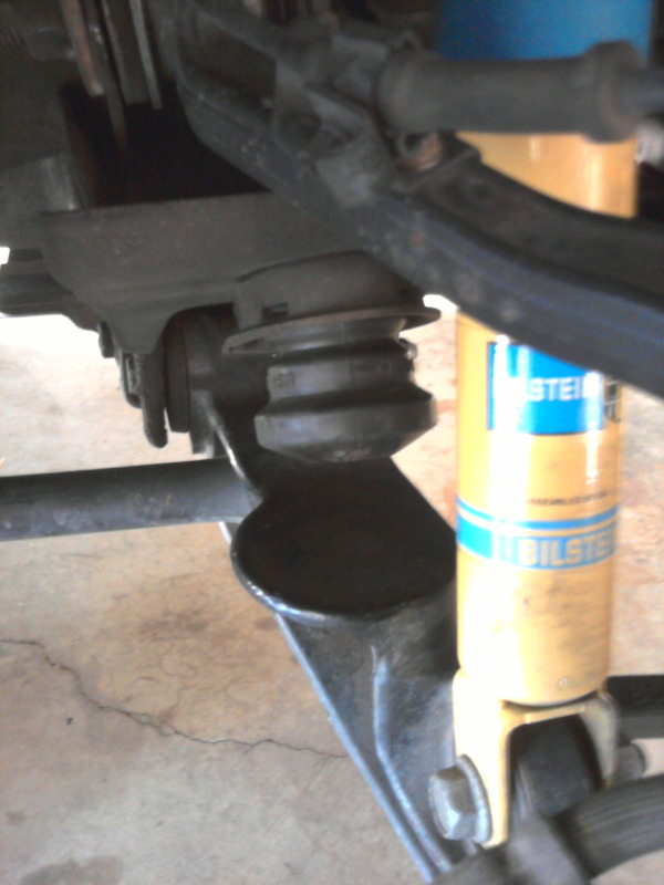

Here was my front bumpstop situation:

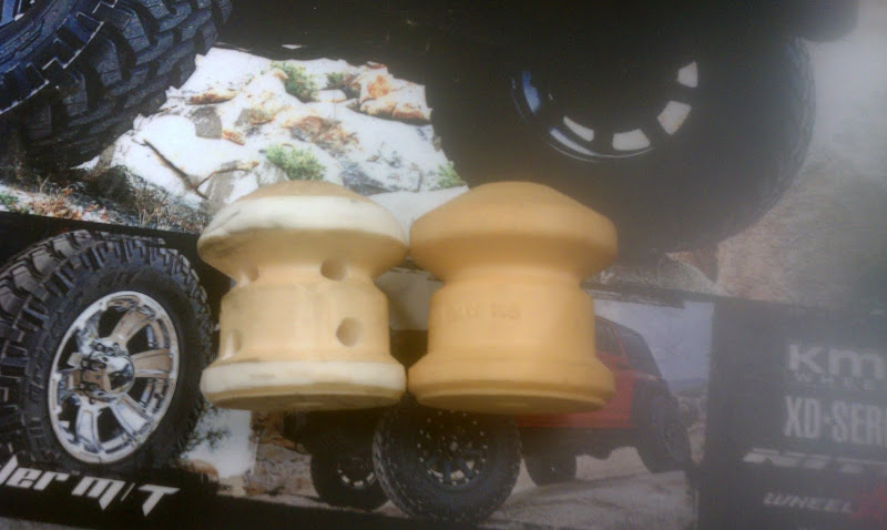

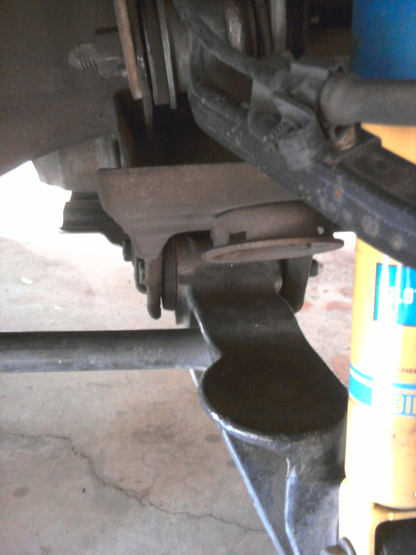

I added these:

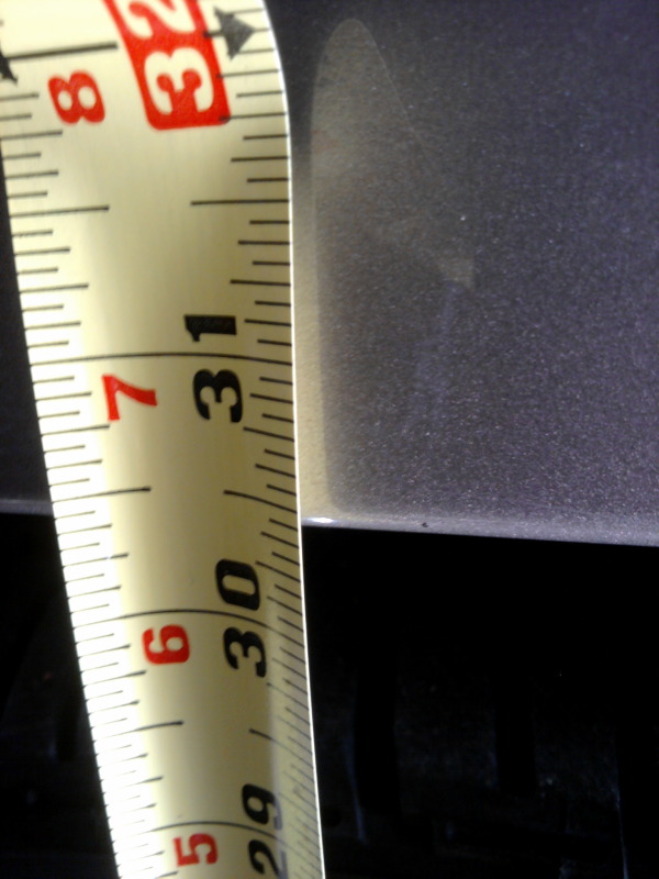

Sadly, it's too high, measures 31.5" up front now and 32" in the rear.
Gonna shave down the bumpstops to get it back down to 31" so I can get a bit of the rake back.
I will concede that it rides a bit better now, lol. I still would like to get it lower all around.
Also want to add that the install took no time at all. I had both bumpstops installed in less than 5 minutes so that was great. I changed the oil while I was down there too.

Hey dude what is the part #? I lost it and need to order some more.
Tahoewhat
Ballin' on a Budget
Sep 20, 2009
3,720
24
TX
#15161762
From your post in 2010, had it saved.
Alex- sorry didnt text you back, didnt want to bother late.
Per Boss's post-- They lift it slightly because the stops are reinforced with a larger lip like an upside down muffin, so control arm rests against them with no room to compress
or heres the thread. lol.. http://www.tahoeyukonforum.com/forum/showthread.php?t=12391

Thanks Mike. I was able to shoot Max a PM as it looks like that PN has been updated with 15153959

I'm gonna try drilling and shaving mine a bit with the bench grinder at work tomorrow if they get delivered. Some guy on the silvy ss forum has belltech spindles + keys just like me and said the stock stops drilled out a bit made it ride smoother. I'll try to take pics and report findings.

Looks good Alex, i happen to be resting on my Z71 bump-stops and it's been like that for the past 3 years and no problems.. im at 32 1/2 in front and 33 in the rear. i have no gap between my rims and body.
