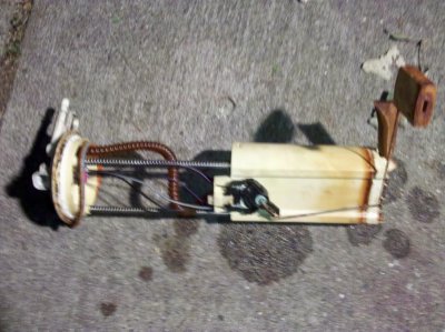

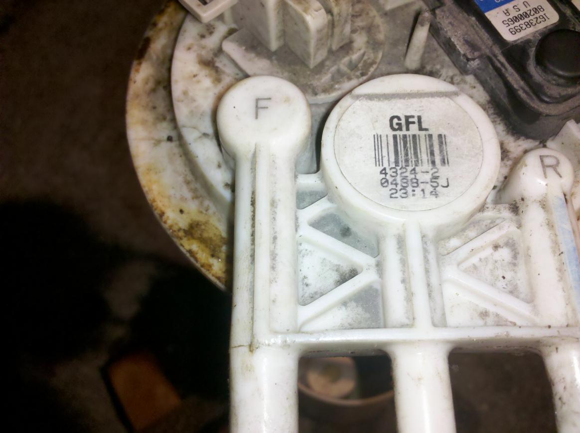

My old one looks pretty gunked up.
After I got it out I beat on it withe a screwdriver handle to See if it would free up, then hookup wires, turned key, no go, I do have power to the connector.
Question: Is the pump itself replaceable ?
I looked At Car-Part.com and apparently they don't sell fuel pump at the JY
Not sure I would want buy one there but I looked
