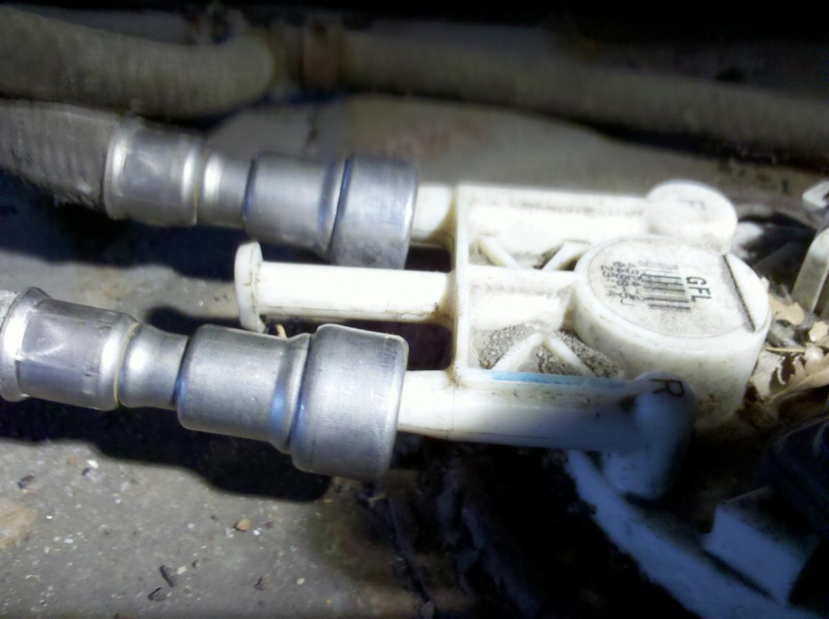

Lines to Fuel Pump, Disconnect Tool Wont Fit ??
HDRock1
May 25, 2012
200
Flint,Mi

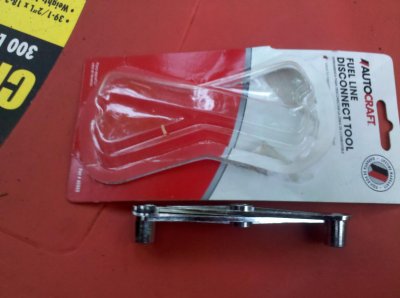

I tried a plastic Disconnect Tool I had ,wouldn't work.
Bought a different tool, but It won't fit between the plastic on the pump and the fuel line.
There is only a 1/4 inch between the plastic and the fuel line.
I'm thinking cut some plastic out on the pump or grind down the tool.
Or where can I get a tool that will fit ?
Tool I bought in pic

HDRock1
HDRock1
May 25, 2012
200
Flint,Mi
I have a full set of the plastic ones.
The tube on the pump is 3/8 so I assume the size tool I need is 3/8 Dia. Am I correct?
But the length of the tools won't fit between the plastic part on the pump and the line to get it in there, I was able to release one side inside the line but not the other side where the plastic bridge on the pump is the way.
What am I missing here

HDRock1
HDRock1
May 25, 2012
200
Flint,Mi
I took the pump out of the tank,(got tank out of the way) so I could turn the lines, then I just used one side of the tool ,then got one side released turned the line pushed tool in again released the other side, and got the lines off.
