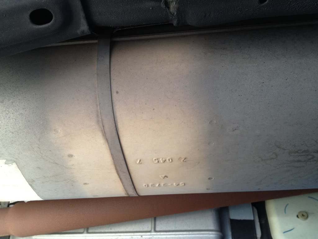

That looks like the stock exhaust Bro with a Resonator delete, but thanks VERY much for the Pics.
